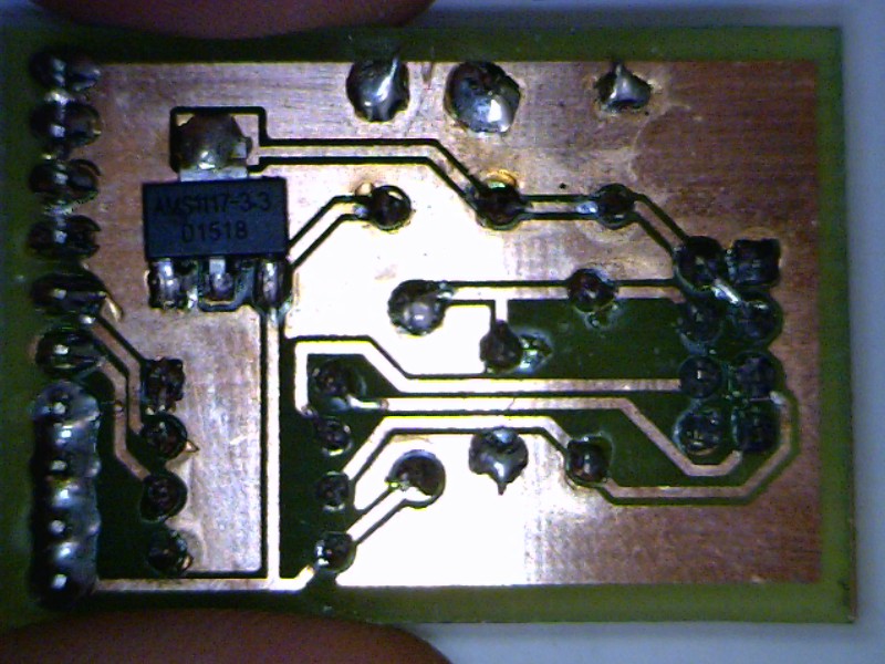

ATTiny85 + NRF24L01 integrated board
Hey everyone, I uploaded two PDFs to share below for board etching. As indicated by the thread title, they integrate an ATTiny85 with the 3-pin NRF24L01 connections provided by NerdRalph. One file contains the component footprints and values, the other contains the traces and can be printed for UV-exposure. You’re welcome to try toner-transfer, but YMMV.
I do have a question about the 3-pin ATTiny85 connections, though. Using that schema, digital pins 0, 1, and 2 are connected on the ATTiny, but in the code provided from here, it defines CE and CSN as pin 3. That presents obvious problems as nothing is connected to D3, and is supposed to be available for use; this ties it up with nothing connected. So, can CE and CSN be define as pretty much anything then, or is there a reason this guy volunteered to delete an extra pin, making this effectively a 4-pin solution?

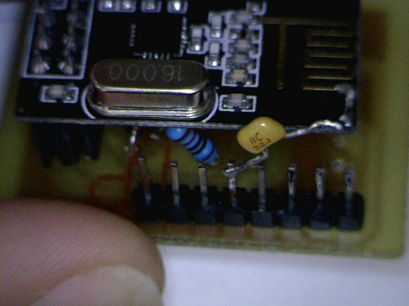

I attached a photo of the top of the board with components below. The NRF module goes into the female header pins.
I ran across some very strange behavior with this board that's pretty much stumped me. I figured out how to fix it, but I still don't know what the problem was, or why the fix worked.
I was testing this board layout, and it does work, but only if I kept my finger pressed onto the tips of the pins of the NRF module. At first I thought it was a connection issue with a loose pin, but after hours of investigating, I figured out that if I put a 10 nanofarad capacitor from the antennae of the NRF to the ground of the PCB, it works perfectly and ran all day without dropping a single packet.
????BUT WHY????

When trying to diagnose the problem, I tried different ICs with different clock speeds, different power supplies including battery. Nothing made a difference, but if I pressed my fingers against the header pins, it worked. Or if I touched my finger to the antennae, it worked. So that somehow suggested to me some kind of capacitance, so I gave it a shot as kind of a Hail-Mary, and it started working like a champ. I used the sender and receiver sketches from here as the code:

The pic with the cap on the NRF is a different board layout of the same circuit as the other two. I went through a few revisions. But the issue was identical between all of them.
