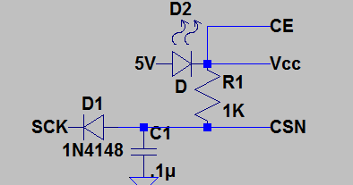

I had discussed this exact project with a buddy, Jack Christensen who supplied also a modified schematic of the one mentioned on Ralphs blog.
Please post back with your progress/updates! It takes a bit of messing with the header files. Here is a list of steps I took following Ralphs blog and Jack's schematic:

according to Nerd Ralph: nrf24l01+ control with 3 ATtiny85 pins, modify the Mirf.cpp as follows:
void Nrf24l::csnHi(){
 PORTB |= (1<<PINB2);  // SCK->CSN HIGH
 delayMicroseconds(64);  // allow csn to settle
void Nrf24l::csnLow(){
 PORTB &= ~(1<<PINB2);  // SCK->CSN LOW
 delayMicroseconds(8);  // allow csn to settle

When connecting the nrf module to a tiny85, connect MISO(pin7) on the module to MOSI/DI(PB0), and not MISO/DI(PB1). Here's the connections required:
nrf module ATtiny85 pin
SCK(5) PB2 (physical pin 7)
MOSI(6) PB1 (physical pin 6)
MISO(7) PB0 (physical pin 5)

a) You have to send commands to the chip and check status bits no matter what you're doing.
b) Why would you want a Nrf24L01 connected to a Tiny85? There's no pins left for any sort of sensors or indicators. Where does the data you're transmitting come from? What can you do with it if you've go no pins left?
By the time you've connected all those extras diodes and capacitors to control the CS pin, what did you gain? You have no I/O pins left and it won't be smaller/simpler/lower power than using a Pro Mini.

Two of the "8 pins" are Vcc and GND - can't be used for anything else.
If you reconfigure the RESET pin for input/output you won't be able to upload programs to the chip. You only get one upload (unless you buy a special programmer).
The only realistic way to do this is to add something like a 74HC595 to the system to gain 8 output lines then connect the Nrf24L01 control pins to that. The Nrf24L01 driver will need a lot of modification to get it working.
