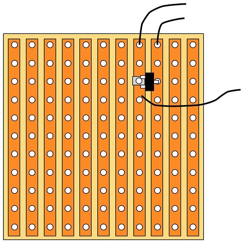

These can be very small if you use surface mounted components. You can do this on the underside of strip board. This picture shows the mounting of a FET, other "bird seed" like resistors can be mounted either between tracks, or between cuts in the track made by a sharp scalpel or knife.
You will also need a pair of tweezers.
A hand-operated new/sharp 4mm drill bit works best for me.
Put in the hole, and slowly turn.

Did you know you can get surface mounted ULM2803A and still solder them to normal strip board if you cut the tracks between the holes in strip board. Like this:-
