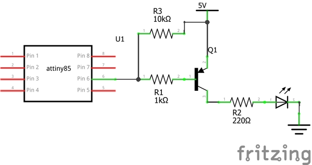

Try 10K pullup resistors on the Arduino pins driving the transistor bases.It sound like the pnp are not switching fully off.
Post your whole sketch. Some comments on lines like those you posted about would be useful.
Hi Paul,
Thanks for your reply, I tried 10K on the base of the red and green transistors but it made no difference whatsoever.
That's not what I said at all. Please read my post again more carefully. If you don't understand the term "pull-up resistor", please ask. I did not say to remove the 1K base resistors.
Sorry, I totally misunderstood.
I don't have problems admitting my ignorance but here I failed to notice that I didn't knew.
Is this it ?
thanks
Yes, that's better. Tried it yet?
If that does not fix the problem, can you try the standard blink sketch? Do the leds go fully out with that sketch?
Well, it did not work.
