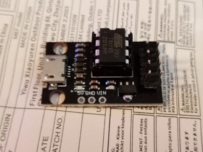

This is what I have. Just the chip and I used one of the chip programmer devices.
I also have another variant where the chip has been soldered on by the manufacturer.
Do you own this board of post #5? If yes, then was it originally a baord without the ATtiny85 chip (Fig-1) on the 8-pin socket and later on you have inserted your fresh chip on the socket?

2. I have also bought the followinh board (fig-2), which comes with a soldered ATtiny85 MCU which contains a Bootloader Program.
Figure-2:

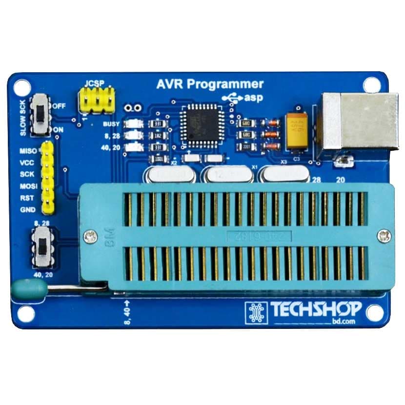

3. Using the following AVR Programmer (Fig-3), I read the fuse bits from the ATTiny85 MCU of Fig-2 and have written it dwon.
Figure-3
4. Using the same AVR Programmer of Fig-3, I have read the content of the flash memory (the Bootloader program) from the ATTiny85 MCU of Fig-2 and have saved as a file.
5. Using the same programmer of Fig-3, I have written the fuse bits of Step-3 into my fresh ATtiny85 MCU.
6. Using the same programmer of Fig-3, I have written the file (Bootloader Program) of Step-4 into the flsh memory of my fresh ATtiny85.
7. I have taken out the ATtiny85 from theprogrammer of Fig-3 and then have placed it into the empty socket of the board of Fig-1. The result is that I have got the following board (Fig-4) with an ATTiny85 MCU which hold Bootloader program.

To me, top board with soldered ATtiny85 is authentic. I am sure that it contains a Booloader Programmer. If you connect it with the PC, it must be detceted. Connect it with your PC navigate throug Device Manager to see that the board is detected.
Again, LSUSB on my Linux laptop will not detect the soldered board.
I switched the ATTiny85 chip out on the other board (I have 5 of them) and that was not recognised either.
I believe the fault is not the chips. I know the cables are fine as I was just using them with Thonny and a Pi Pico. The USB is also fine.

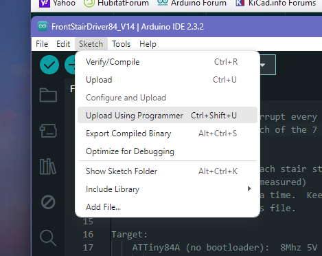

Its been a while since if programmed my ATTiny. I didn't take good notes and I have windows, however I do know you have to initiate programming using an option from tools.
