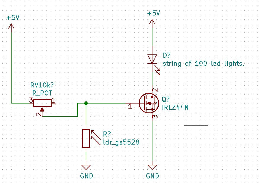

A while a go I made a super simple automatic lights on/off switch for my 4.5 volt chrismas leds (100 pieces) using a potentiometer and an ldr (gl5528) and an irlz44n mosfet.
This works great for a while now.

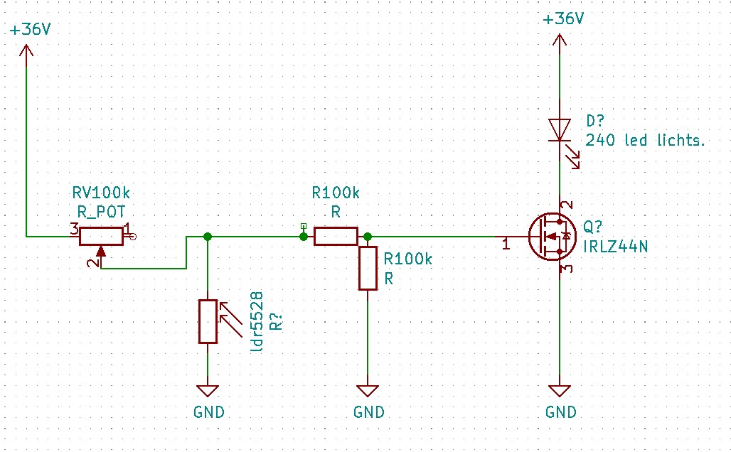

Recently I bought a string of 240 leds and wanted to the same but this string is using a 31volts power supply instead of 4.5 and I am stuck how to use the same construction since the voltage is way to high for the gate of the irlz44n. I have been looking for other mosfets with higher gate.source tolerance but they do not seem very common? I found some that can handle upto 30 volts but thats not enough.
I tried a setup with an extra voltage divider place after the pot/ldr but I could not turn the some of leds of completely (green ones stayed on but I am sure it was below 2 volts on the gate) and I think I turned the pot to far to zero ohms and things started smoking again.
I could of course use an arduino nano to switch the mosfet or maybe a buck converter but it feels like overkill and it needs a bigger box to put every thing in.
Any suggestions how to solve this with simple components?
I added 2 pictures of what I tried. The voltage is 31 not 36.

it should be obvious your voltage divider should be BEFORE the pot and LDR in order to protect it.
Also, the LDR can be incorporated in the voltage divider but the voltage divider values should be appropriate
for the LDR.
If you do the math, assuming the LDR resistance is 20k worse case: (highest light resistance=lowest light that it
responds to) (not sure what it should be for dusk)
4.5V/20000 = 0.000558A
36V/ 0.000558A= 4,444.444 ohms or, approx 4.7k, NOT 100k.
Try replacing moving the voltage divider to before the LDR and change the values to 4.7k for both resistors
Put the pot AFTER the 4.7k voltage divider and BEFORE the LDR.
The DESIGN CRITERIA is 4.5V@ 0.000225A to 1 mA.
4.5V/36V=0.125
Voltage Divider Vout=Vin*[R2/(R1+R2)]
Vin = 36V
Vout = (desired = 4.5V)
Let R2 = 680 ohms
R1 = 4700 ohms
Vout = 36*(680/(680+4700)
= 36*(0.126)
= 4.55V
R1 (upper resistor of divider) =4.7k
R2 (lower resistor) = 680 ohms
Put pot AFTER voltage divider.
Jury is still out on the mosfet but everything to the left of that should work as calculated.

You should design your circuit so that mosfet has in the range of 5 to 10 volts on its gate when it is on and 0 volts when off. It should not be held in an intermediate state.

My first try with a voltage divider was with a 10k/10k divider. The 100k pot was just to have a wide range to experiment with.) So Thought lets try 100k so it would have less impact on the first divider (pot/ldr)
But I just realized the divider has to be before the pot if only to prefent smoke for apearing when I turn the pot to 0 ohm in bright light and all power.

I add the circuit I used for the 4.5 volt 100 led string. Which was a 3XAA battery powered string which I replaced with a 4.5v adapter. This is an old style transformer type adapter which is at about 7 volt with no load and goes down to 5/4.5v with load. It is a bit weird since when the voltage on the gate gets high enough for the mosfet to let current flow the voltage drops a little and the flow should show again which raised the voltage... but it works perfect for weeks now. with only 3 parts.

Often a Zener diode is used to limit voltage on a MOSFET Gate.
macron0:
MOSFET gate drive voltages can be anything from a couple of volts for low-voltage logic
drive, upto 12V.
Note the gate drive voltage for your 30V example will be 12V (as determined by the Rds(on)
being given for Vgs=10V). The gate-source breakdown voltage is something you want to keep
well away from at all times as the device will fail instantly if the gate-oxide breaks down.
12V is assumed to be a 12V battery, which in practice means 10V to 14V range, so they always
give the specifications for 10V, the worst-case.
Its easy to drop voltage for your circuit using a resistor and zener diode, as the power requirements
of the pot/LDR are low. For dropping 36V to 5V at about 20mA a 5.1V zener and 1.5k 1W resistor
would work. 20mA should be enough for the LDR circuit I reckon.
BTW you want to run your LDR circuit at low-voltage ideally anyway, as self-heating in the
LDR might throw the results and it might overheat too.
LDR might throw the results and it might overheat too"
It should be obvious that this is the reason the
voltage divider must be before the pit and LDR.
(and the divider should be the values I gave)

I gave up the passive parts method and went for a nano clone ( and buck converter) to read the ldr and that switches the mosfet on or off.
I will try the zener solution for future projects. That should work. Very good advice. But after days of trying someting I thought to be so simple I lost my patience.
This way it works too. I did learn a lot from all the replies. So thank all very much for you help.
