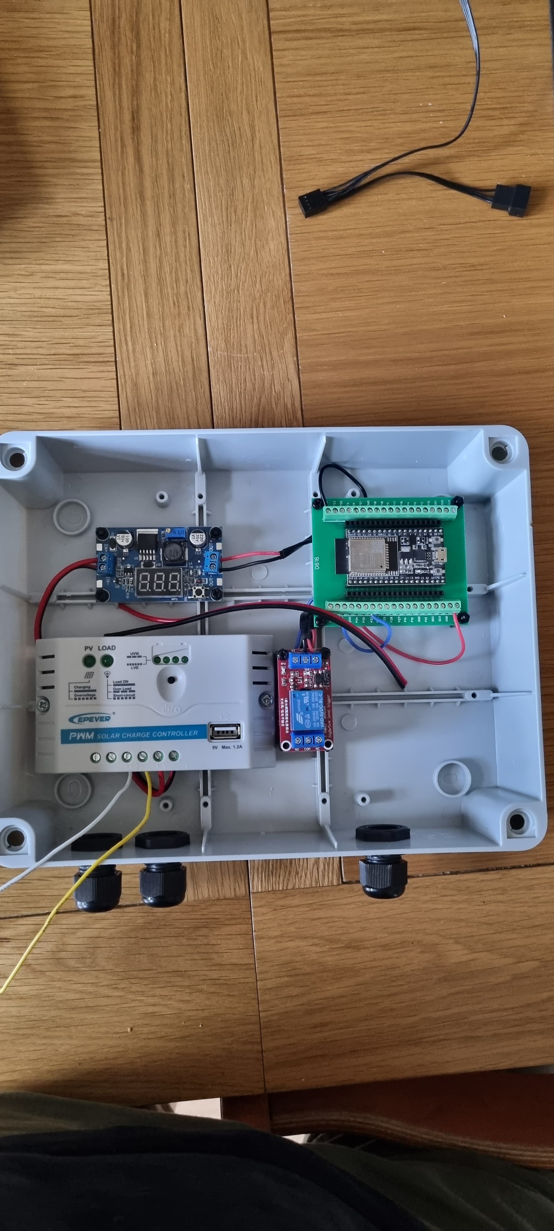

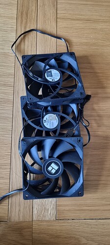

In addition to the above system I built last year, I've moved over to an esp32, and included a SHT20 temperature and humidity sensor and 3x 120mm pc fans.
The idea is the SHT20 keeps an eye on the Temp & Humidity and triggers one of the fans as an intake fan to cool things down. The other 2 fans are used as air circulation. Both sets of fans are controlled by individual PWM and powered directly from the 12v battery via a relay.

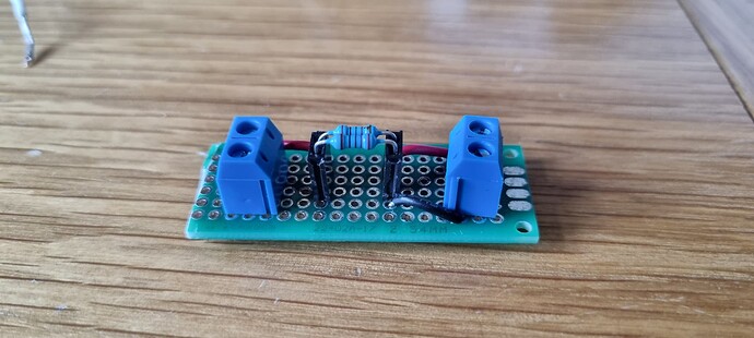

I've built a little voltage divider with changeable resistors to get the voltage down to 3.3v (its a little less but will account for it in the code) to measure the PV voltage.
All the data will eventually be sent to a website hosted on a RPi Zero 2W, which will be accessible externally. I've trailed the website and its working fine. Just need to get the database set up.
I'm trailing this all in my mini greenhouse full of chillis before taking it to the allotment.
