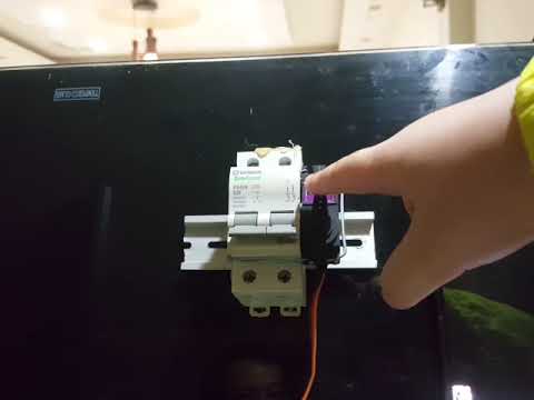

Im looking for a circuit braker for arduino to shut off powerconnection between battery/charger and battery/ arduino. Basically shutting itself off. This is the best I have so far. Does it exist any better solution? Maybe a circuit braker with integrated programmable input?

Ok, but what im looking for is a circuit breaker controlled by the arduino, maybe with a relay or integrated relay. The circuit breaker is for 12v DC 20/30 amp. and 16v dc 30 amp and 240v ac, normal, probably not more than 10 amp.

Yes, as you can see, my first post, this video. A steppermoter flipping the switch back and forth.
