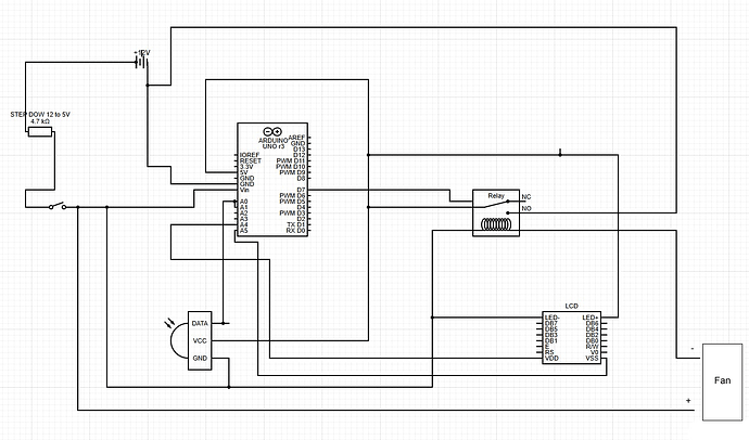

Good day everyone, I tried making an Automated Toxic Fume Recirculator, but there is a problem with it; when i set the toxic fume level to 500 it supposedly automaticaly turn on and vacuum the fumes, but it turns out the opposite way, it automatically start at 500. When i try to blow air on the MQ2 the toxic fume level decreases, here is my sketch that ive made. Can you guys help pls :< SOS
Sketch:

Schematic Diagram:
Maybe swapping the wire from NO to NC on the relay module will solve the issue?
Your topic does not indicate a problem with IDE 1.x and therefore has been moved to a more suitable location on the forum.
i tried swapping it, but the lcd is not showing indications anymore.
You shouldn't power arduino at 5V to VIN.
If you use 5V power source you need to wire it to 5V pin.
For VIN you need at least 7V.
Wouldn't you want to exhaust toxic fumes instead of recirculating them?
I see several problems, here are a few. The relay coil should not be connected to the fan.
Vin requires at least 7 volts to be stable.
Your 12V can power the arduino via Vin and also the fan through the relay contacts. The relay requires a isolation from the Arduino pins. Many relays are available that have transistors to to the isolation. Even if the Arduino port has enough power the inductive kick back from the relay coil will fry it. You can buy relay modules that have the driver already mounted along with the relay and an opto coupler.
Your display will only light up at best it is missing several connections. This may help with the relay:
