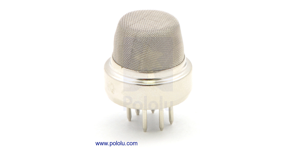

I am trying to build a networked smoke & gas detector. I got a few MQ-2 sensors to hook up to my Arduino (Uno with WiFi Shield) via my breadboard.
My local suppliers didn’t have the ones with the breakout boards so I have the “raw” 6-pin sensors.
I have gone through the data sheet (http://www.pololu.com/file/0J309/MQ2.pdf) as best I can. I have also looked at the Arduino Playground page (http://playground.arduino.cc//Main/MQGasSensors) as regards the sensors and tried to follow that as best as I can. I have also looked at some video examples. But they all seem to be using breakout boards for their connections…
But I am lost in the wiring. Basically I see there are 2x A pins, 2x B pins and 2x H pins. My understanding is that I should be connecting the two A pins together, the two B pins together and the 2 H pins together. My assumption therefore was to run two wires from the two A pins to two holes in the breadboard but in the same column, two wires from the two B pins to a same column in the breadboard and two wires from the two H pins to a same column in the breadboard. I would then run one wire from the A pin column in the breadboard to the Arduino, one from the B pin column to the Arduino and one from the H pin column to the Arduino (ie 3 wires from the breadboard to the Arduino).
The sensor appears to take 5V directly and I am going to need to add a load resistor (from 2kOhm to 47kOhm) connected to the ground part of the circuit.
My basic problem is that I can’t decipher which of the sensor pins goes where. I believe one of the pins goes to the 5V, one goes to GND and one goes to an analog input port such as A0. But I don’t know which pin (pair - column) corresponds to each of these.
From the Playground page I believe the A pins go to the 5V. But I’m not sure. I then don’t know which goes to the GND (B pins or H pins). Whichever goes to GND then gets the resistor between it and the GND on the Arduino and the other pin pair goes to A0.

Look at the bottom, see the pictures here for A, B, and H (don't look at the schematic, that is different). http://www.thaieasyelec.com/Review-Product-Article/Gas-Sensor-Getting-Started.html
The pins in the middle are 'H', that is the heater. One of the 'H' should be ground, the other 'H' should be 5V.
Connect both 'A' pins to 5V. Connect both the 'B' pins to a load resistor and to Arduino analog input.

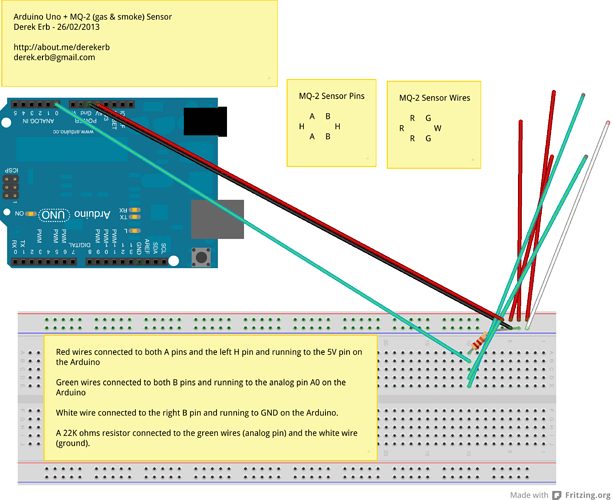

I tried taking pictures but you can’t see much on them. I made a Fritzing diagram instead which you’ll find attached.
I have attached red wires to both A bins and the left H pin.
I have attached a white wire to the right H pin.
I have attached green wires to both B pins.
On the breadboard you’ll notice a 22k ohms resistor in the same column as the 2 green wires and heading to the wire which goes to A0.

I’m sorry… the Fritzing files I uploaded were wrong. They didn’t correspond to the wiring I had done.
That incorrect version had a black wire going from GND on the breadboard to 5V on the Arduino and nothing going from the power row to the Arduino.
This new version has the correct, in that it corresponds to what I’ve done, wiring.

No, the sensor is not damaged that way, but the output is not correct.
The load resistor connects to both 'B'. You have that. But that should also go to the analog input. The load resistor must also connect to ground.
The heater should warm the sensor, after 5 or 10 minutes the metal of the sensor should get warm.
The 'signal path' is like this: 5V to both 'A' pins -> 'A' to 'B' is the sensor -> both 'B' pins to resistor and to analog input -> resistor to ground.
Also, 22k is very high. The output could be at the maximum. I would suggest to use 2k2 to start with. Even with 2k2 it should be very sensitive.

That last message from Erdin was what I needed. The resistor needs to be connected to both the GND and the Analog input. You can see the newly corrected Fritzing attached.
I knew it had worked as soon as I ran the original code on the new wiring. It started with values around 790-810 and slowly went down and down to the 500s and then the 400s and finally it settled around the upper 360s after 15 minutes. That’s when I decided to test. I lit a match underneath the sensor and it went crazy. It shot to 800 immediately. I blew out the match and it stayed up in the 800 range and hovered there while the smoke billowed in my hand. When I moved my hand away and let the smoke dissipate it dropped to 600 and, a few seconds later, slowly worked its way back down to the upper 360s.

Well done. Your wiring is okay now.
You have to do the burn-in time, see that MQ-Sensor page, http://playground.arduino.cc/Main/MQGasSensors
