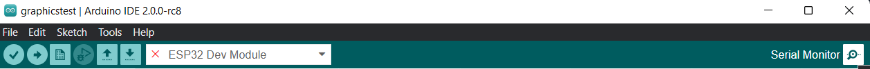

The Serial Monitor is where it has always been, far right on top:

That is where its icon is but you cannot open the Serial Monitor in its own window, which is a shame.
You can, however, move it from the bottom of the screen to the side but I can't for the life of me remember how
EDIT : you can make it full screen but not see the code window at the same time by double clicking on the word "Output"
