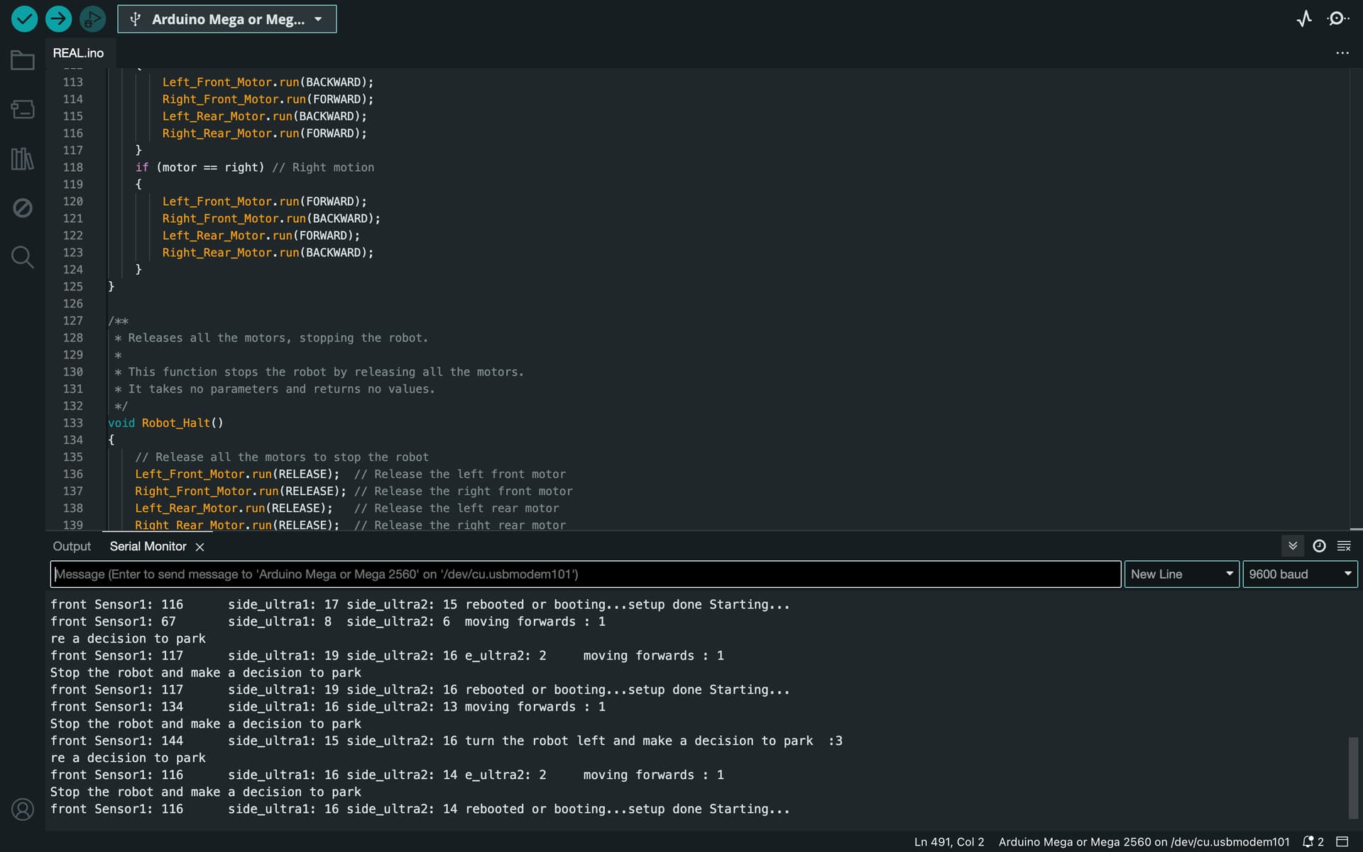

there was multiple issues at the start:
1-the vehicle was not moving at the start unless i connected it to my laptop
2-the vehicle kept on rebooting once it reached the middle of the parking spot as shown in the image attached (also attached the serial monitor)
for this specific code testing i have removed the infrared sensor to focus on the rebooting issue for now. Use code tags to format code for the forumif possible please help me get rid of this rebooting issue, if any further information is needed please let me know

    Serial.println("rebooted or booting...setup done Starting...");

Welcome to the forum.
You might want to look at this How to get the best out of this forum before you proceed any further.
You can not run a motor directly from an Arduino pin, first and foremost because there is not enough current from an output pin to drive motor. You will damage your Arduino if you insist on this.
Second all DC motors need a reverse biased diode to prevent voltage flyback damaging your Arduino.
Third posting a screen dump of anything is useless and just a waste of time. Just copy and past anything you want us to see. Just like you posted the code.
Finally I moved your post here because it has nothing to do with boot loaders.
When the Mega is powered from USB, you need to remove the Yellow jumper on the motor shield. When you disconnect the USB then you should replace the Yellow jumper.
You have to know how to parallel park before you try giving instructions to parallel park. It's not about "enough space," rather the right amount of steering at the right time.
