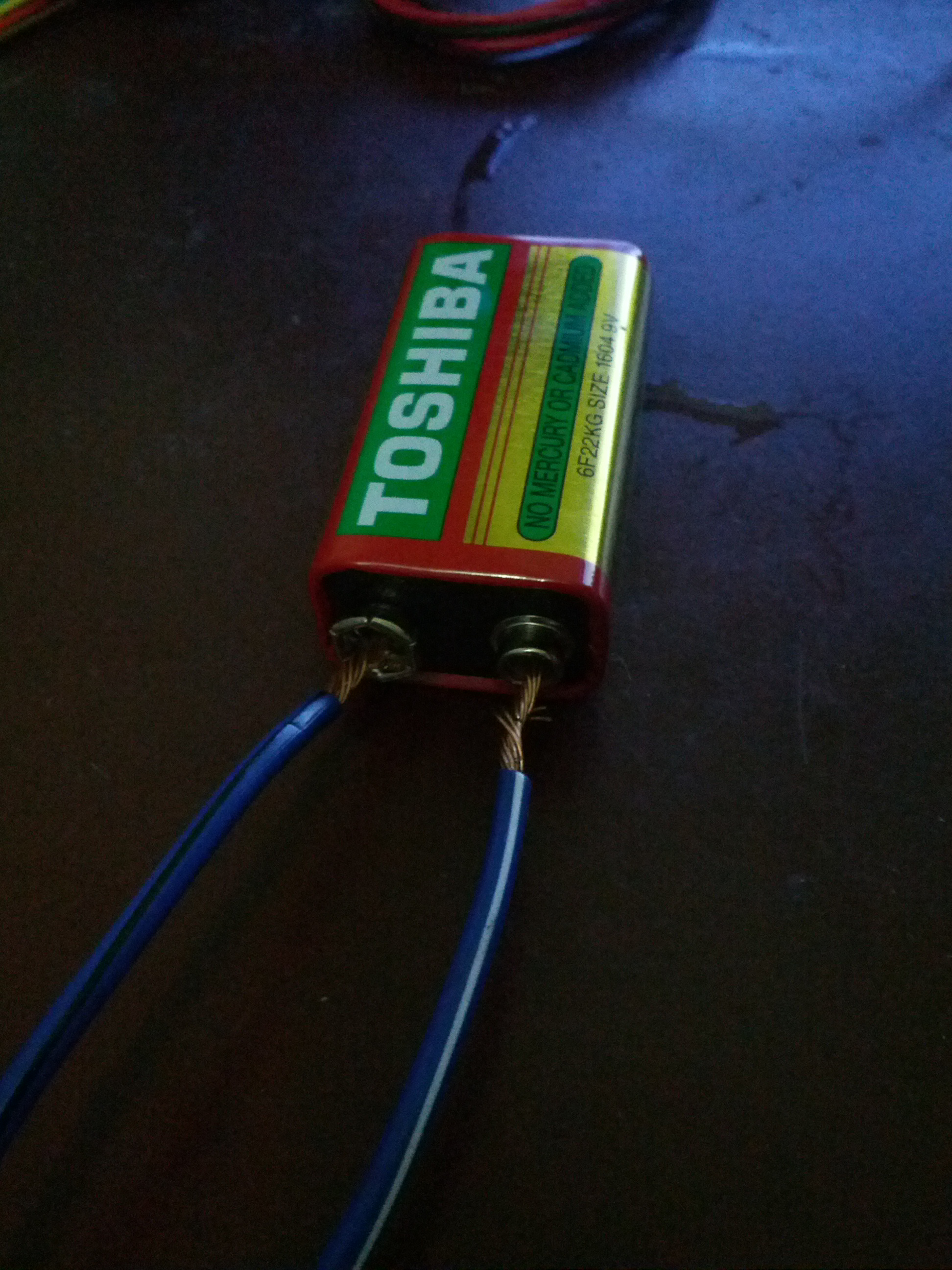

Guys so im running into a problem
I tested the pump at the car shop, he just plugged it into this huge var battery and I heard the motor of the pump running
But now when I hook up my 9V nothing happens :confused:
This is how I just hooked it up just to test it
http://d24w6bsrhbeh9d.cloudfront.net/photo/axNA0mn_700b.jpg
Any solutions? :confused:

This pictuer
And no , its from a 12V car (I assume this since it's written 12V on the pump)
But the folks above said that shouldn't be a problem
I now connected the two batteries in series (totaling 18V) and still nothing happens
You can see a few sparks flying when touching the pumps wires though
Those 9v batteries are not very good at supplying large currents, I suspect they and not up to the job of driving that motor.
You can prove that by monitoring the voltage when you connect the motor, I bet it drops significantly.
Get a battery with more grunt.

Even I suspected that it might be an amperage issue
Roughlyhow many amps do you think it would take to run this?
What kind of battery would I be needing? :confused:
I was hoping to show this off tomorrow, sigh :confused:
for a demonstration, you should be OK. it will not last a couple days.
