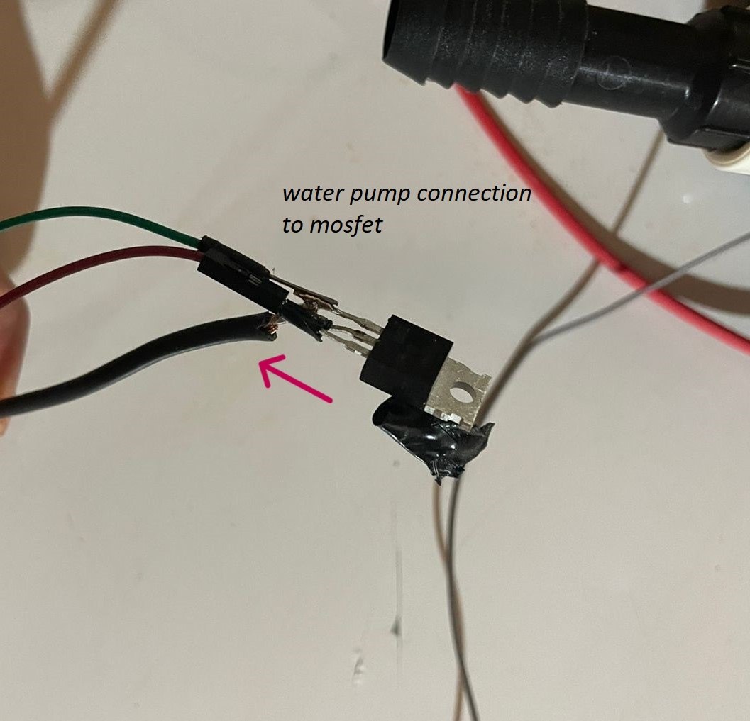

Hello, I'm doing a project, and I want to know if you know the correct connections to make a mosfet work with a water pump, since I want to control it with an Arduino. I'm leaving some photos here so you can see.If you could guide me to make a correct connection
The time you spent drawing those little arrows could have been used to sketch out a clear schematic on paper, take a well lit photo, and send that.
I expect things to get smoking hot, so avoid touching the MOSFET when it is powered. On the first try, a short between the drain and gate will likely damage the MOSFET.
Post an annotated schematic showing exactly how you have wired it, including all connections, power, ground, power sources, and other components. Additionally, provide a link to the motor's technical specifications.
If you have started writing code, post that as well.
Be sure to include the exact pump model number, and or ALL the information on the ratings plate and/or a link to the exact pump at the manufacturer's web site; ditto for your power supply for the pump; also include the exact part number of that MOSFET, so we may ascertain whether it will be suitable for the job.
I'm sure there's more we'll need, but start with that.
Thank you for being kind, I will try to make the connection diagram, it is the first time I am doing a project in this way. I also have to clarify that when I press a button, what I would be doing is through the Arduino to make a stepper motor work and at the same time I want the water pump to turn on. The code and the motor part are already ready. What I am having doubts about is the connection with the water pump since I want to control it through the Arduino.
At this point you've allowed two previous threads to die without responding to posts from others.
Should we expect this thread to also die unresolved?
Hi, I'm just trying to resolve my doubt, and as I told you, I already resolved the problems in the previous forums. Now it's a totally different problem. I'll try to answer the messages and let you know if it's resolved. I'm just trying to figure out if someone has the knowledge to help me. :grinning:
And we're trying to figure out what it is you're doing in detail. But, detail continues to be lacking.
To give good advice requires that we have some confidence about how you're doing the job, not just that your doing it. There's a million schematics for wiring a MOSFET on the internet, so grab one, sketch your circuit particulars around it, post that sketch, and maybe you'll get some advice.
Yes, that is exactly what I am doing, as I just answered another person. Right now I am making the connection diagram. I will be passing the connection diagram soon. Thanks. :slightly_smiling_face:
