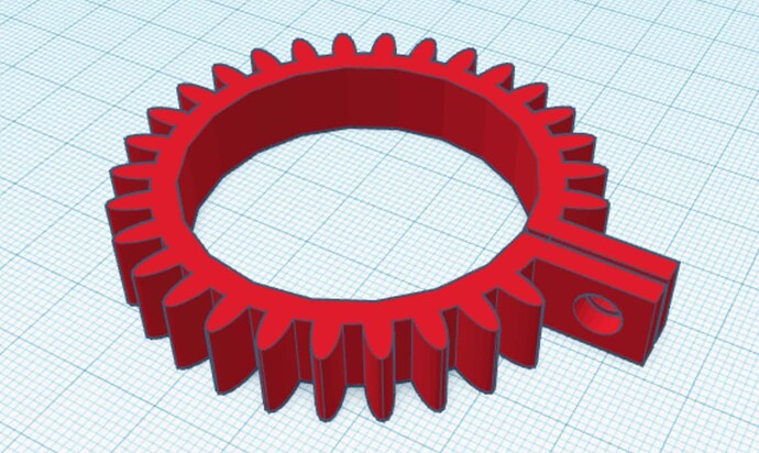

I'm looking to automate the in my apartment.
I se to solutions.
the cheap solution:
get an ATmega328P, servo motor, and potentiometer.
use the potentiometer to input and adjust the heat. have a timer code that shuts the heat off at night. I do this by 3D printing an engine holder for the stepper motor, and a gear clamp (se the pic) That goes on the heat adjuster for the radiator. power the whole thing with a battery. The problem is mainly the arduino/ATmega328P ability to tell the time as i see it.
The more advanced approach would be to use and ESP8266 wifi unit to control the motor and the use a NTP protoco tell the time, and thereby knowing when to shut of the heat. This is of course a more complicated code but I'll figure it out.
So the question is, is using an ESP8266 and a 9-volt battery the best solution and how long do you think the battery will last? Is there a way to use the ATmega328p Since this will be cheaper?

Have you measured the force required to change the setting? Ours are very stiff.
