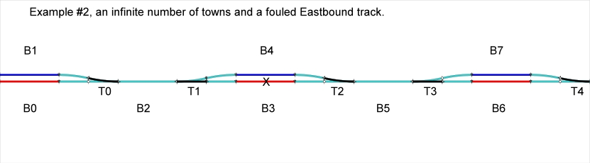

I've attached a second example layout that connects 3 towns together.
Consider an Eastbound train (moving from left to right) that just showed up on B0. Normally, it would travel from red track to red track as it makes it's way Eastward.
In this example, the Eastbound train can't proceed normally, because the next red track is fouled. However, it could proceed to B6, the next available red track, if B2, B4. B5 and B6 are not occupied, and no warrants have been issued for the mainlines B2 and B5. I know that a warrant has not been issued when the turnouts T0, T1, T2 and T3 are in their default conditions.
When I check a list of things, I build a bitwise representation. For example,
Checking blocks 0,2,3,4,5,6 returns 010111...if a train qualifies to to move from B0 to B6.
Checking turnouts 0,1,2,3 against their default alignment, returns 1111...if no track warrants have been issued for the mainlines B2 and B5.
To issue this longer than normal track warrant, I have to align turnouts T0 and T1 opposite their default alignments. In addition I have to lock T2, T3 and T4 in their default alignment until the train arrives in B6.
Checking blocks 0,2,4,5,6 after the train arrives in B6 returns 11110.
Checking turnouts 0,1,2,3 after the trains arrives in B5 returns 0011
The turnouts T0, T1 will be returned to their default positions, after the train arrives in B6
The GreenSteam GSP-14 Automatic Signal Controller will take care of all the signals.
Chaz
bhuck:
When that's not possible, I need to look ahead 2 or more paths...looking for the next free block in the correct direction. That is, and eastbound train can use a westbound siding in the first town, if it can get to an eastbound siding in the second town. Sounds like recursion to me.

I imagine having a series of track sections - let's call them A B C D E F which get a train from A to F or from F to A
For some of them there may be pairs - say B1 and B2 and D1 and D2
Suppose that for the direction A to F the options B1 and D1 are preferred.
Then the software would check to see that all the elements B1 C D1 E and F are clear before setting the route.
If, however, it found that D1 was not clear it could then consider D2
In practice I think the order of checking would be (B1 or B2) C (D1 or D2) E and F. If any of them failed it could not set the route.
I don't see any need for recursion (which can get very tricky, especially with limited RAM) - just a system of priority.

My program has several arrays, indexed by the path number, that include lists of things associated with that path.
In my second example, there are only 4 short paths.
Blocks per short path, ordered from source to destination
0, 2, 3
3, 5, 6
7, 5, 4
4, 2, 1
Turnouts per short path, ordered from from source to destination
0, 1
2, 3
3, 2
1, 0
and 2 long paths
Blocks per long path
0, 2, 4, 5, 6
6, 5, 3, 2, 1
Turnouts per long path
0, 1, 2, 3
3, 2, 1, 0
So, all I have to do is loop through the short paths and then the long paths, looking to issue and revoke track warrants.
For a short path, block occupancy 011 (3), indicates a train in the source block and the mainline and destination blocks are empty. Block occupancy 110 (6) after that train is completely in the destination block.
For a long path, block occupancy 01111 (15), indicates a train in the source block and all the other blocks are empty. 11110 (30) after the train is completely in the destination block.
The switch statement for short paths has case 3 and case 6. 3 to issue a track warrant and 6 to revoke a track warrant. The switch statement for the long paths has case 15 and case 30. 15 to issue a track warrant, and 30 to revoke a track warrant.
I'll code it up next week, after I figure out when a block is fouled.
Chaz
0, 2, 3
3, 5, 6
7, 5, 4
4, 2, 1
I'm a little confused by this because none of them seems to be the inverse of the other - eg how do you get from 3 to 0 ?
In any case, let's assume that physically 0, 5, 3 is also an option - but 2nd preference because 5 is normally used for the other direction of travel.
Then I would add that group as another path to be considered if the first path 0,2,3 fails. (these numbers are just for illustration - please substitute sensible ones)
...R
