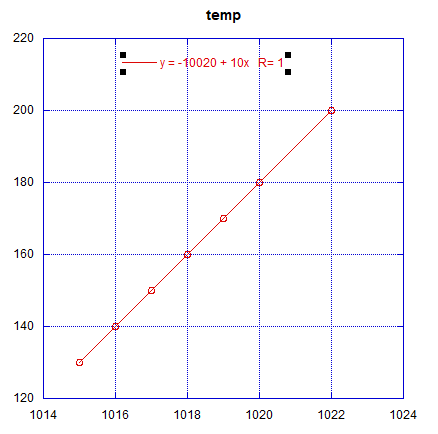

I'm trying to create a gauge cluster using Arduino. Last night I was trying to calibrate temp (f) into analog numbers. My readings were.
120(f)- 1012
130(f)- 1015
140(f)- 1016
150(f)- 1017
160(f)- 1018
170(f)- 1019
180(f)- 1020
200(f)- 1022.
I'm wondering if there is a way to rescale this so I can get a range from 100(f) to 250(f). Or do I have to buy a new sensor to accomplish this?

If you posted your sketch it would help but in its absence (HINT), what you are looking for may be the map() function
Without seeing your code, it's difficult to say, but it looks like you would need the map function which does just that, maps the numbers to a different range of your choice. See details of the function here: Arduino Map() function
BTW, how are you representing your Automotive Gauges? are you using CSS gauges?
Nobody ever needs the map() function. It is a fancy wrapper on the simple linear equation
y = mx+b
that most of us learned in grade school.
The function is purely a convenience, often a simple linear scaling will be enough, and so more straightforward and easier to understand.
Your question is purely mathematical. Get your hands on a book of simple linear algebra and the solution will appear to you very quickly. Or, look for help on a math forum.
You may have a bad data point, which means the data can't be rescaled in a reasonable way. See below. If you delete that point, then a linear fit works very well.

Here is the code. My goal is to rescale it so I can read higher temps without maxing out the analog input. If that is possible.
int value;
int value = analogRead(A0);
Serial.println("Analog value : ");
Serial.println(value);
delay(250);
