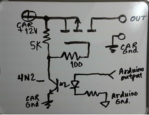

No you don't want any resistance in the gate leg as that would allow the gate capacitance to flap about creating an unwanted voltage on that terminal. The only way to get proper control is to use the bi-directional current source that is the totem pole which alternately charges and discharges the gate capacitance. It does not matter that you may not be able to get your head around why it is so, just accept that it does.
NOSUM
I wonder if this subject is still about turning a P-channel FET on/off anymore.
The "opto" could be just about any 4N2_ or 4N3_ device (or whatever with an NPN (photo)transistor output).
The resistor there would be enough to get 10mA or so through the 'LED' (270Ω).

As mentioned, I'm not sure optocoupling is viable in this part of my project, but I'm also working on power management for it (I'll start a separate topic when I'm ready to explore this further) and have been struggling with how to provide external switching (human-switched) information to the Arduino. Optocoupling is definitely the way to handle this. Thank you for reminding me of them, Runaway. :slight_smile:

dephwyggl:
I'm still (yeah, I know) wondering how large that 1.5kOhm resistor attached to 12V can be and still have things be reliable?
Both of the "base" resistors (1k and 1.5k) can be increased to around the 5k to 10k mark without changing the operation too much. Will slow it down just a little.
What do you want to achieve by this? Is it to decrease power consumption? They already only require small 1/4 Watt resistors, and they only draw current (about 13 mA total) when the mosfet is turned on. They draw no power when you're not modulating it.
The problem with that circuit is that the chosen mosfet requires about 50 nC removed from the gate just during the transition (fall time). Your circuit only does this at a rate of about 1 mA and so will take about 50 microseconds. The switching losses start to become the dominate loss at this point, something that the op is trying to avoid.
Dirk: I should point out that at low modulation frequencies like 500 Hz you can still get away with a simple one stage (npn) solution with just a pull up resistor. The resistor needs to be down around say 680 ohms though (might be too much load for the opto though) to keep the fall time under about 5 microseconds and hence keep the switching losses relatively small (compared to the on state loss). A resistor of this value starts to dissipate a bit of power though, so you'd need to go up to around the 1/2 to 1 Watt range.
If you want to give yourself the option to later go with higher modulation frequencies however, then you're better off staying with the "push-pull" (aka current source-sink) driver stage.
Observation: I've seldom seen the gate/base of a (P)MOSFET/transistor without a resistor before it - totem pole and others. I'm aware though, that this does not say anything about the practice's validity or otherwise.
The resistor improves damping but is otherwise often optional. In your case however, once you add the gate zener it is no longer optional as you need to limit the zener current. Otherwise you've got a 1W zener trying to absorb the entire energy of the transient, and there's no guaranty that it can do that and maintain its rated voltage (and not die).
It was mentioned previously (by another member) that you shouldn't use a gate resistor, but instead you should limit the current on the base side of the driver transistors. The problem with this is that it makes the effective gate drive resistance becomes a function of the transistor's large signal current gain Hfe (aka Beta).
