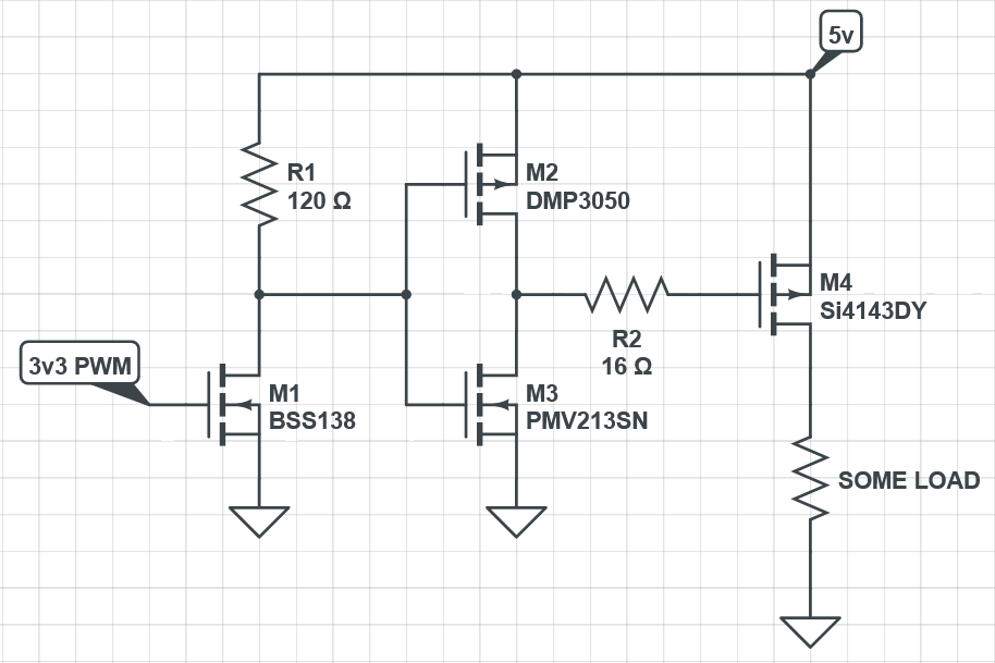

I would like to drive a p channel mosfet, since i could not find a suitable driver for my application on the store i am selling, i am kinda forced to make my own pmos driver . Im hoping that you guys can check my work if there are problems in my circuit or component selection
The PMOS i am using is a SI4143DY. I have learned that a MOSFET must be driven by low impedance and the best way i could think of doing that is by a totem pole circuit NSS40301 and NSS40300(Sorry cant hyperlink the datasheet the forum limited me to 2 links). The maximum freuency i want to switch at is 1MHZ. I am also using a bss138 nmos as a level shift instead of an NPN so that i can eliminate the gate resistor.
I suppose that the output should not be active when there is no PWM signal. That means the gate must be high, and Q1 must be off. However, it is turned on with R4. I think that R4 needs to be 10k to GND.
The two transistors is a safe way to amplify a digital signal. The output signal will be 1.2V lower, even up to 2V according to the datasheet.

I forgot to change the value, it should be 120 ohms since the bss138 can only handle 200mA of current.
I see my mistake , and actually i agree with you now that i checked again. An "OFF" PMOS have a gate voltage of the same as Source, to do that the bss138 must be OFF. an OFF bss138 there must be a pull down.

Probably not, but the combination of that gate resistance and the 1MHz and the 6nF just feels problematic. All that energy has to go somewhere, so you have to check the temperature of the components.
No, its good and the circuit is inherit safe. Just keep in mind that the output signal can be 2V less top-to-top.

This worries me what do you mean 2v less >? Im worried that at my lowest source voltage (5v) i might not turn it adequatly on, 3v might still be off for this mosfet.

There are a few versions of the NSS40300 / NSS40301 transistors. The "MZ", "CT", "DD" and "MD".
Manufacturer's page of the "CT": https://www.onsemi.com/products/discretes-drivers/general-purpose-and-low-vcesat-transistors/nsvs40300ct with datasheet.
Its VBE(sat) is maximum 1.0V. Also the Figure 7 shows that at 40°C it is near 1.0V.
Since both transistors have that, the output at the emitters can be 2.0V lower (top-to-top) than the power supply. That is the price that you pay for a circuit that is inherit safe.
The mosfet has a lower RDS(on) with a gate voltage of 10V. With a power supply of 5V, it should work for a load of a few amps.

Oh no looks like i have to go transistor hunting again. I have to look for a transistor that has a Vbe sat of 0.5v.
Can replace Q3 with a Schottky diode (Q1 can pull the gate to ground via that diode).
Then Q1 must be able to handle the gate current + pull down current, so not a BSS138.
