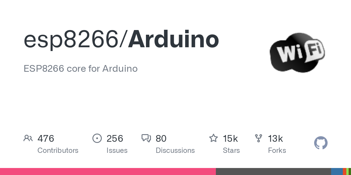

Hi @cx32. Thanks for your report. This file is the compiler used by 3rd party boards platforms such as "ESP8266 Boards":
It is not used by any of the official Arduino boards and is not part of the Arduino IDE installation (though you can install those 3rd party boards platforms using the IDE's Boards Manager).

@cx32 please upload the file to VirusTotal and then share a link here to the results page:
Thanks. The file from my installation of the "ESP8266 Boards" platform also has the same hash, so we know your file was not tampered with.
False positives from antivirus software are unfortunately quite common, but of course we also must always be vigilant about security. This means it is difficult to know when to take such a detection seriously. I think the best thing you could do is submit a report to the ESP8266 Boards platform developers:
It is possible they will be able to do an investigation and perhaps to request AVG to correct the false detection if their investigation finds it to be so.

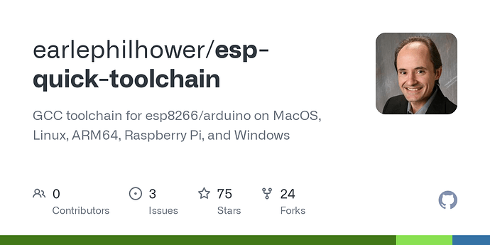

In theory you should be able to compile this tool from the free open source GCC compiler source code if you would like to remove some links from the "chain of trust" of this file.
I believe that there are some proprietary components in the ESP-SDK, but that is completely separate from the "xtensa-lx106-elf-gcc" tool that is triggering the detection.
Beyond the "ESP8266 Boards" platform repository at the URL I shared above, I believe the next step would be here (this is the project used by that boards platform to build the file:
OK have downloaded the ZIP, expanded it and looking at the readme.
OK will compile my own version of that file.
1st thing is Run: make download.
Have Win 7 (64) and no executable called "make", further down using the git command. Have no executable named "git".
Not found any file named "download"
Have raspberry Pi 4B and been using git there, but need this on the Win7 PC.
So not familiar with this and it has presumption I don't know to make it work.
And/or other software is needed that is not stated.
