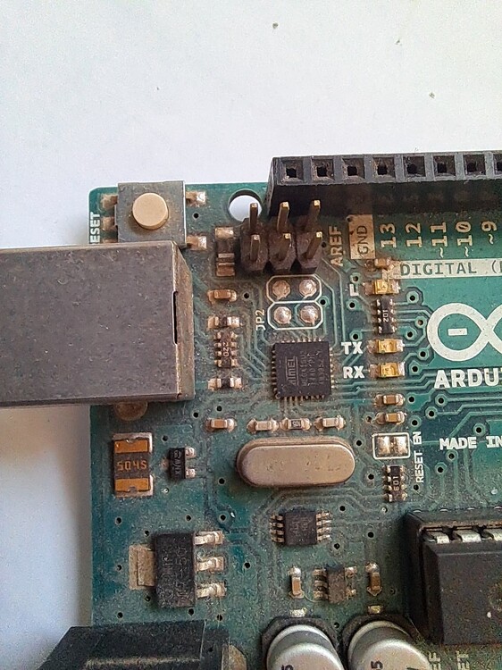

An IC is an Integrated Circuit. In the below image it's the black square between the USB connector and the RX and TX LEDs.

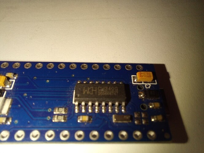

Instead of the square IC you might have a rectangular one like below (image from a clone Nano).
So if you can post a photo like in the first image it could help.
