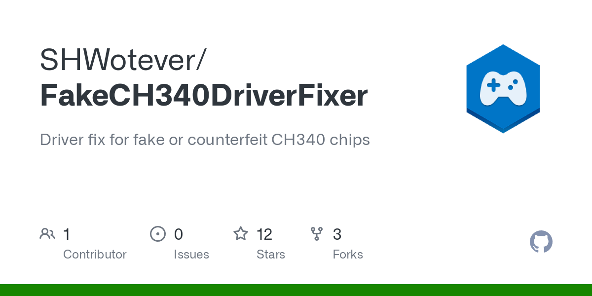

Another possibility is that the electronics community could produce some sort of fix or mitigation. We are already doing something of the sort by disseminating the instructions for a workaround. There is something along those lines here:
However, the problem with community solutions related to drivers is trust. It is wise to only install drivers obtained from trusted sources. This means that even if someone from the community produces a perfect fix with nothing but good intentions, it might only end up seeing widespread adoption if that community member can somehow establish trust (which could be through reputation or code signing).
Another interesting possibility might be for a workaround to be implemented in the AVRDUDE uploader tool. That wouldn't necessarily provide a universal solution since those working with affected hardware using other applications might still be affected (e.g., esptool is used instead of AVRDUDE when uploading to ESP32 and ESP8266 chips and those development boards frequently use the CH340), but it would at least provide a significant mitigation for the Arduino and related communities. It is not clear whether it would even be possible to implement a workaround for this driver level problem at the application level. There is a discussion about the problem in the AVRDUDE issue tracker:
but no indication of a possibility or intent to implement a workaround in that codebase.
