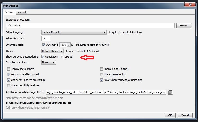

All my sketches uploaded normally to my Uno board until I installed a 3rd party MPU6050 library and uploaded the example calibration sketch(which did not work).
Now, every time that I upload a sketch I get some avrdude diagnostic information about things like port number, baud rate, AVR Part (ATmega328P), chip erase delay etc etc. Then it reads on-chip flash data and finally 'avr done. Thank you.'
It also mentions the location of a configuration file but I am loath to mess with it in case I make matters worse as the board is still usable.
How can I get rid of these annoying messages and why might they have started appearing in the first place?
Many thanks
P.S. I would have included the full list but I could not copy the text from the small black window below the sketch.
Most often it is as a simple as opening the IDE preferences and turning off VERBOSE.
