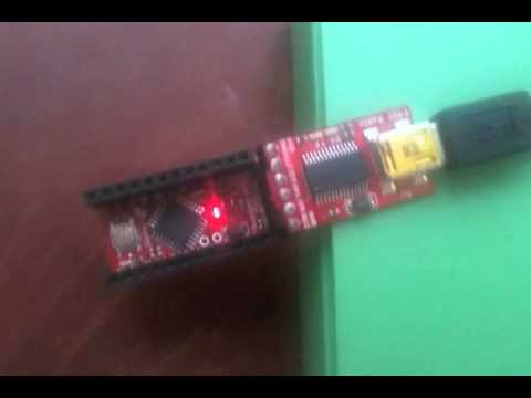

Arduino: Sparkfun Pro-Mini ATMega 328 (5V)
OS: Mac OS X 10.6.8
Arduino s/w: 0022
cable: FTDI 5V5
For a review of the steps taken to get this error see this video:
There must be something going on with this configuration that avrdude doesn't like.
Thanks,
Jon
w1jp

I have this same problem with my brand new Sparkfun Ethernet Pro board. Ethernet Pro - DEV-10536 - SparkFun Electronics
I'm on Mac OS 10.6.8 with Arduino 0022 and I also use the 5V FTDI board they sell. I've loaded the latest VCP drivers from FTDI's site. I've selected the correct port and processor. I'm powering from the USB port. The board lights up as expected. I'm attempting to upload the simple Blink sketch as a test, and get this error. Same thing with any other example sketches.
The kicker is, this setup works fine with my other unit, the Sparkfun Arduino Pro 328 board. Arduino Pro 328 - 5V/16MHz - DEV-10915 - SparkFun Electronics
That bad boy has the same processor and everything. I have no reason to believe this is a problem with the board - the bootloader works as shown in the video w1jp provided. My board also appears to have a test program pre-loaded which runs the Ethernet module. It's lighting up the LEDs and appears to be attempting to connect to Ethernet, so it's not DOA.

If I am not mistaken, from the video, and the descriptions (especially as PMsteve has a working board, and a none working board) it sounds like a boot loader error. Or a sync issue due to incorrect board selection.
I am not certain about the solution that Avi mentioned. Seems reasonable, however the FTDI basic should not need modification to work. It is definitely functional as it comes from Sparkfun.
