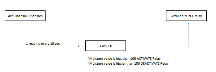

I'm'using Amazon IOT as a broker, the problem is I have another arduino to control a pump, and I have no idea how to when AWS IOT sends a topic to this pump the pump starts
I did not have idea how to setup the YUn as a subscriber, process the data and the activates or not the pump.
For example, when the Sensor unit send a moisture value lower than 100, the aws console process this info and sends a topic called Relay1 with value 1. This activates the pump.
Many many thank's for your help.
Best
Eduard
Hi Eduard,
I want to help you, but I do not understand your setup. Can you make a drawing of your setup and with the communication between them?
Br,
Martijn
Hi Martijn,
First of all thank's for your help and patience.
See the drawing attached
Many thank's
Now I understand the setup. And if I'm correct you do not understand how to subscribe, correct? Please check following tutorial:

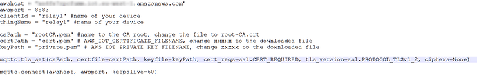

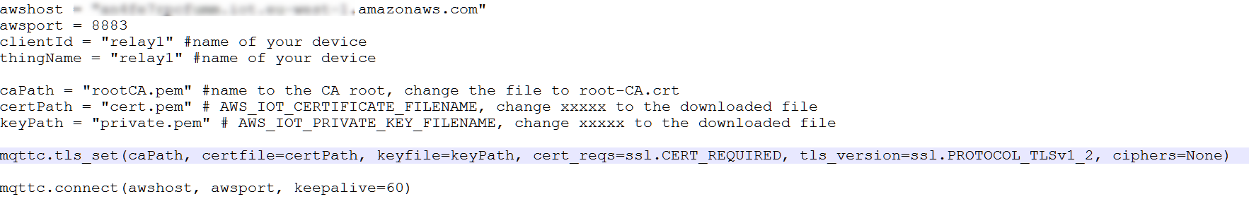

Hi Martijn,
I read the article and I saw that it's for a Rasberry but I thing it's the same code. See attached the subscriber and the publisher code files.
I was comparing with your code and basically i saw a difference with the way to connect with AWS.
Is it possible to use your code with the conncetion setup used in the project?
WOW many thank's for your help and patience, but there is no place to learn this kind of thinks
Eduard
awsiotpub.py.txt (1.7 KB)
awsiotsub.py.txt (1.42 KB)
I just did a quick check. We need to update my code with the right credentials. See below. I got it working on ubunutu. But it should also work on your yun.
If you login to aws and choice the IoT service, you ca create your "own thing". Once created you can push the button "Connect device" (button below).
No you can download the appropriate certificates. Please also download the Root CA (save file). If you push next you will see the names which yu can use below.
Now you have them local, please upload them to your Yun. You need to upload the CA root, AWS_IOT_CERTIFICATE and AWS_IOT_PRIVATE_KEY certficates. Put them into your directory of your source code. Now I alreadt changed the source code for you. You only need to update CA root, private and CERT name in the source file.

Hi Martijn
We are heading to the end of this :-), but I did the python.py file, and when I executed, i received this response (response attached)
You know why?
Many thank's
Eduard
mqttc.tls_set(caPath, certfile=certPath, keyfile=keyPath, cert_reqs=ssl.CERT_REQUIRED, tls_version=ssl.PROTOCOL_TLSv1_2, ciphers=None)
mqttc.connect(awshost, awsport, keepalive=60)
--> change mqttc to client
client.tls_set(caPath, certfile=certPath, keyfile=keyPath, cert_reqs=ssl.CERT_REQUIRED, tls_version=ssl.PROTOCOL_TLSv1_2, ciphers=None)
client.connect(awshost, awsport, keepalive=60)
Hi Martijn
I updated the filed but I had the same error, did you test it in an Arduino?
many thank's....
Eduard
