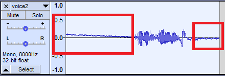

i'm working on project to record audio I managed to record audio at a sample rate of 16 kHz and a super good 48kHz with STM32F103C8. But the problem is that I have background noise in the recorded sound. and I used different methods

Hi
I did all these things

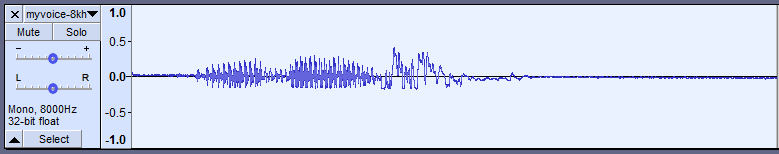

This is my voice and you can see the noise
myvoice-8khz.zip (11.2 KB)
No, I am not going to download a zip file. And your voice is not the noise. Please tell us if your scope shows the noise as regular or is impulse. A picture of the scope trace would also be helpful.

What you show in reply #7 is probably not ADC noise.

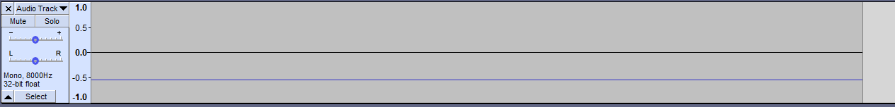

To measure the ADC noise, remove the microphone and connect a 10K resistor from the analog input to ground. Use the shortest possible leads.
I tried this it works but I can only get a positive peak
So, the problem lies not with the ADC, but with the input coupling and microphone. Post a complete schematic.
