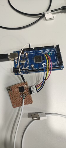

For an apprentice and his project, we try to flash an Atmega32U4 as almost completely bare chip.
Of course, directly from mouser, the Chip is not recognised/programmable via USB directly.
At least the Bootloader is missing i understand (Correct?)...
So, we tried to flash the bootloader via "Arduino as ISP" thru a Mega2560.
The fact that i am posting here, indicates, this flash was unsuccessful... :wink:
So, what did we do?
  • Connected Arduino2560 and gotten COM11 assigned.
  • Arduino Mega2560 sucessfully flashed with ArduinoISP-Sketch on COM11
  • We added the 10uF-Cap on the Arduino2560 between Reset and GND
We also added 100nF on the 32u4 at:
  • Pin 14 VCC --> Pin 15 GND
  • Pin 34 VCC --> PIN 35 GND
Connected “bare” Atmega32u4 chip to Arduino2560:
  • Arduino 2560 VCC on ICSP-header (Pin 2) --> 32u4 VCC (CPU Pin 14)
  • Arduino 2560 GND on ICSP-header (Pin 6) --> 32u4 GND (CPU Pin 15)
  • Arduino2560 MOSI on ICSP-header (Pin 4) --> 32u4 MOSI (CPU Pin 10)
  • Arduino2560 MISO on ICSP-header (Pin 1) --> 32u4 MISO (CPU Pin 11)
  • Arduino2560 SCK on ICSP-header (Pin 3) --> 32u4 SCLK (CPU Pin 9)
  • Arduino2560 DIO10 --> 32u4 /RESET (CPU Pin 13)
In Arduino IDE, we then set:
  • Board = “Arduino Leonardo” (As it also uses 32u4) but we also tried “Sparkfun Pro Micro” which also has 32u4 (Both gave the same results further below)
  • COM = COM11 (The Arduino2560 is there with the ArduinoISP-Sketch on it)
  • Programmer = Arduino as ISP
When we click “Burn Bootloader”, we get:

So... I checked 3x and resoldered everything twice... All okay.
Have checked for shorts: nothing
To the picture:
  • The 32u4 is on a doublesided sticky tape.
  • The white USB cable is not plugged in as this will be used AFTER we flashed the bootloader to use direct USB-Flashing (As i understand the Bootloader is needed for this?).
  • The unlabeled wire in white is the Reset of the 32u4 which is connected to Pin10 of the Arduino2560.
And no: When we connect the white USB of 32u4, nothing is recognized really... no unknown device or even a refresh in the device manager...

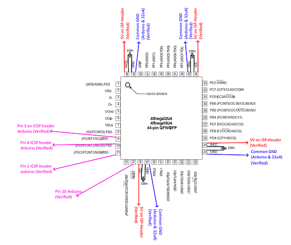

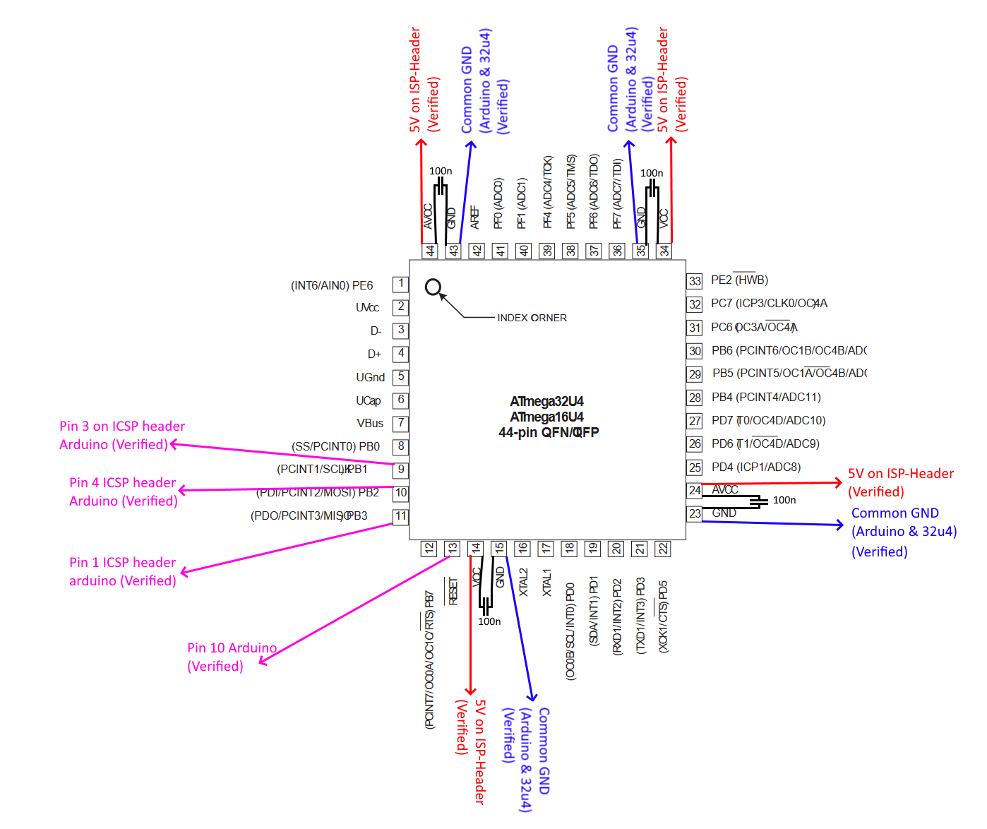

Schematics....
I will deliver Schematics tomorrow as today i am working externally.
But it will be a graphical representation of the info i already posted in first post:
Maybe a stupid question, but is it necessary to connect the supply (5V) to more than just one VCC-Pin of the 32u4? Is it required to connect 5V to ALL VCC? Like Pin14 AND Pin34? Maybe even to AVCC (Pins 24 & 44)?
GND only on Pin15 enough or is it also Required on 23, 35, 43?
I saw in another post the mention of Pin33 (/HWB) to be connected to GND... Needed?
I assume, Pullup on /Reset of 32u4 is not needed as it is connected to Pin10 of the Mega2560 and the sketch pulls it up/sets high correctly...
ALL AVCC pins MUST be connected to +5
ALL VCC pins MUST be connected to +5
ALL ground pins MUST be connected to Ground
Bypass caps on all VCC pins.

Okay... So i will re-try and connect ALL those pins. I assumed (Probably wrongly) they are connected internally... Ahwell... :sweat_smile:
Why the AVCC also need +5V? Arent they for A/D-Conversion and thus (in my understanding) not used in Flashing via MISO/MOSI?
Of course i will hook them up to 5V as suggested by you two. I am just curious why the AVCC are needed in this scenario...
Actually not sure why but for any AVR device datasheet I've read, they always say they must be connected for serial programming and must also be connected whether you use the ADC or not.
True. I just checked the Datasheet of 32u4 (https://ww1.microchip.com/downloads/en/devicedoc/atmel-7766-8-bit-avr-atmega16u4-32u4_datasheet.pdf) to confirm it was used for A/D-Conversion.
  • The AVCC is the supply of the A/D-Conversion
  • And it needs (According to the datasheet for that pin) to be connected to VCC if no A/D-Conversion is in use and be connected to VCC thru a Lowpass filter if A/D-Conversion is in use...
The only hint on why it is needed for for Serial prog (And by this i assume you mean USB?) is found in Figure 21-1: The AVCC seems to power the "PLL & Div/2" block which gives the USB-Interface its clock... No AVCC --> No Clock on USB-Interface --> No USB-Communication --> No USB-Flash.
However, we are here with MISO/MOSI and an own clock (SCK), so this shouldnt be the issue i think.
Figure 28-1 also shows the use of AVCC on 5V but this is for Parallel programming. Also not what we do here with MISO/MOSI...
Hm!
Probably the solution lies in Figure 28-10 and its subtext:
Serial Programming with SCK, PDO and PDI which IS what we try to do: MOSI/MISO and SCK + Reset....
And this clearly shows the connection to VCC on Pin for AVCC. Subtext (Notes 2) on this Pin tells:
VCC - 0.3V < AVCC < VCC + 0.3V, however, AVCC should always be within 1.8 - 5.5V
I think it is this which blocks our efforts to flash...

No, AVRs witout USB also require it for serial programming.
Correct.
I wrote this post as i dug my way thru the Datasheet.... Not the only hint in retrospect but the first.. :wink:
Chapter 28.8 "Serial Programming Pin Mapping" is holding the answer that it is needed as written. Sadly, the datasheet is very shy in terms on WHY it is needed... Havent found it yet at least :smiley:

  • I attached ALL VCC and ALL AVCC to the +5V from the Arduino (ICSP-Header).
  • All GND are connected as well (Also thru ICSP-Header).
  • All AVCC & VCC have per Pin their own dedicated 100nF cap directly on the Pin to the GND just one over.
  • Note: /HWB is not grounded, but i tried it with GND there as well... Doesnt change the result...
  • All those connections were optically checked AND beeped thru with a fluke from the 32u4-Pin to the header-Solderjoint of the Arduino. All correctly connecting.
  • I also checked every connection i made on the 32u4 for shorts one pin over. No shorts, all adjacent pins are "open"
  • All AVCC and VCC pins on 32u4 measure a correct 5.00V
  • the 10uF Cap from Reset to GND on the Mega2560 (ISP) is present
With the hardware wired,
  • I flashed again the Arduino Mega2560 with the ArduinoISP-Sketch. Successfully.
  • I changed the type of board to Arduino Leonardo and kept the COM (11)
  • I changed to Programmer "Arduino as ISP"
  • "Burn Bootloader"
    Sadly, the result didnt change from previous attempts:

I think i will try to scope the lines a bit.... Maybe there is a hint....
