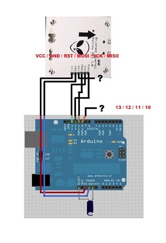

I have been working on a project, making a quadcopter flight control board, with some much needed help from Crossroads :slight_smile: from files released under Creative Commons. The processor used is an Atmega32u4 and the documentation that shows how to burn the bootloader, use a USBasp programmer. I am finding it impossible to get Windows 7 to install the correct drivers for the programmer I have tried a variety of drivers by manually pointing Windows to the driver location but it keeps "insisting" that the right drivers are already installed, being what I assume are the generic Windows ones. Consequently the programmer just comes up as Unknown Device.
My question is can I use the Arduino Uno R3 as an ICSP and if so which of the two sets of pins do I use seeing as there are two, one labelled ICSP for USB interface and the other ICSP for Atmega328 See image and thanks to Nick for that. Here are the instructions supplied to facilitate the burning of the bootloader to the flight control board.
Neither. Those are the headers for programming the two avrs on the uno.
If you google Arduino as ISP you will see that pins 10 to 13 on the uno connect to the SPI pins of your avr.
Thanks somedude, so they are to receive data not send it in a manner of speaking :slight_smile:
Well, they both serve for in-circuit serial programming the two devices on the uno, with communications going two ways on each one when you have a programmer connected.
In a sense, yes, you can use those two headers, one at a time, to "send" programs to the 16U2 or the 328P.
To program another AVR with the Uno you need to put that device's reset pin to low, so that it goes into programming mode. The Uno, when used as a programmer, will use pin 10 for that purpose, so that is why you can't use the header. the other 3 SPI pins: SCK, MISO and MOSI, are connected to both the ICSP header and to pins 11 to 13 on the Uno, but you need an output pin (10) to drive Reset low on the device being programmed.
Thanks for taking the time to explain. Yes prior to thinking about trying to use the Uno to flash the bootloader onto the Atmega32u4 on this flight controll board (FCB), I soldered a Atmega32u4 to a breakout board and successfully flashed the bootloader onto it and verified its success by uploading a modified blinky to it. Then I went to try and flash the Atmega that is in circuit on the FCB, via the programming pins on it but as I said the USBasp programmer will not work because of a Windows driver issue that I cannot resolve. This is when I thought that maybe I can flash the FCB Atmega the same way with the Uno as ISP. The bit that I am having trouble understanding is that I look at pins 10, 11, 12 and 13 on the Uno and yes D11 is Mosi, D12 is Miso, D13 is SCK so they all correspond to the same pins that are available at the FCB programming pins but D10 on the Uno is SS, which I think is Slave Select? but the other pin required on the FCB is RST not SS as on the FCB. Can I do this and if so how do I connect it please. Sorry for the rudimentary image
First, make sure your special board is ok to power with 5V and has 5V logic levels, because that is what the Uno is going to supply to it.
Make sure the ArduinoISP sketch is loaded on the Uno before you connect the other wires and the capacitor.
Connect your 2 question marks together. Select on the Tools, Programmer menu: "Arduino as ISP"
Select on the Tools, Board menu "Leonardo" then, Tools, Board, Burn Bootloader.

I am still having no success in burning the bootloader to this flight board with the Atmega32u4 as the micro controller. I decided to try the Arduino Uno as ISP method again using digital pins 10 , 11, 12 and 13 as RST, MOSI, MISO, and SCK respectively with GND and VCC with a 10uf cap between reset and GND and this is what it generated:

So I assume that the crux of the problem are the lines
avrdude: Device signature = 0x000000
avrdude: Yikes! Invalid device signature.
When I googled this it seems to possibly point to the fact that there is no functioning oscillator in the micro. When I looked at the error output above it says "Oscillator : Off"
There is a 16mhz resonator on the flight control board, is this of any help in diagnosing my problem please.
Thanks in advance Pedro
Well I am about out of practical ideas. Double and triple check your wiring before going any further.
The supporting circuitry on the board, such as the resonator, could be bad. I suppose you could remove the resonator and replace it and see what happens. Or with the resonator removed you can apply an external clock signal to the xtal1 pin of the target chip, using an alternate version of ArduinoISP sketch that provides clock out such as Adafruit's version.
Or you could have a short or open on the board. You need to do some meticulous tracing with an ohm meter to find problems.
If the problem is with the processor, the fuses may be set to disallow serial programming, which means you can no longer use ICSP on it. In order to recover from that you would need access to a great number of pins on the processor and do high voltage parallel programming to recover the fuses. You would probably need to remove the processor using Chip Quik or other SMD removal alloy and temporarily solder it on a plain breakout board and program it, then transfer it back, or get a fresh ATmega32U4 and remove and replace the chip.
Thanks for your reply dmjlambert.
The perplexing thing is that the board is functioning correctly but it is just not showing up in device manager, so if I want to reflash a modified version of the operating code on it (a common scenario with processors used for these applications), I cannot do this via the Arduino IDE. I would assume that if the resonator was defective then the board would not be operating as it currently is if that makes sense. Is there any way that I can read what the fuses are set to? Maybe one of Nick Gammon's pieces of code
If the board is functioning, but you can't program it, it could be because the fuses were set to specifically disallow further programming, either by accident or intentionally. If ICSP programming can't even read the device signature, it will not be able to read the fuses. There are sketches which can read the fuses from within the board itself, but you need to be able to load the sketch on the board. It seems whoever sold you the board should be able to tell you if it is programmable and help you program it.
