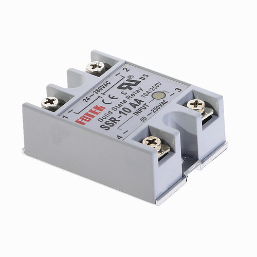

Tell me if I am wrong but (after a REALLY quick look on google) SSR doesn't seems to offer a "double throw" output (COM + NO + NC). And I really need this kind of output for my blinds.
For a board with a relay, sorry, no. If I want a relay I will most likely buy just a relay, bare, not on any board, from RS Components. I don't believe that's what you are looking for.
I agree with @Koepel about getting a quality relay. Sorry, not much help.
Because I am still in a process of learning how to make it work (because my long term project is to have a smart home without using proprietary tech), I prefer to take my chance my aliexpress.
If I broke something, or order the wrong object, the financial impact is less important.
So if I try with a SSR, what kind of SSR do I need?
https://fr.aliexpress.com/item/4001315228183.html?spm=a2g0o.productlist.0.0.29636ac7AWWAMP&algo_pvid=4204a942-2296-4a96-8ab2-eb695aa1b04e&algo_expid=4204a942-2296-4a96-8ab2-eb695aa1b04e-21&btsid=0b0a187916231897492053745ed1d9&ws_ab_test=searchweb0_0,searchweb201602_,searchweb201603_
or
Both should work if they are not fake. They probably are both fake.
0.76 euros for a real Omron SSR ? I don't think so.
