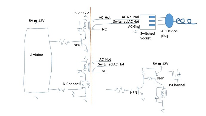

  1. Larry D - I am confused by the first diagram...a lot going on here...perhaps too much for me to understand at this point! Is there decent free software for making these kinds of diagrams? If so, maybe I can try to diagram out what I'm thinking about for a first attempt and then get feedback on that :slight_smile:
In the first image there are different ways of controlling LEDs, relays, and motors demonstrated.
Concentrate on one example output at a time.
Pick the method that best suits your application.
There is a free version of Eagle you can use for schematics.
I use WinQCAD (not available from the author any more) some free versions on the web still.

Larry D - Ok, I understand the diagram better now, I thought this was all meant to do something cohesive :slight_smile:
Can you or anyone else :slight_smile: clarify a few items on the diagram?
  1. What are the functions of R14, R15, R20? Why was a 1k resistor chosen for r14/r15, but a 470 ohm for R20? Why these resistances at all vs a lesser or greater resistance? What would happen if they were entirely excluded from the circuit?
  2. Is R18 a pull down resistor? Why this denomination of resistance?
  3. Does R19 serve the same function as R14/R15/R20? Is this necessary with a FET? In researching transistors, my understanding was that there is almost no current draw from the gate pin of a FET anyway.
  4. What is the function of R21? Wouldn't this arrangement result in a small current flowing into the base of Q9 and thus Q9 would always have flow between the emitter and collector? I don't understand what the arduino pin 6 does in this arrangement, it just seems like if LOW the transistor has a small flow through it (+5v, through R21, into the base), and if HIGH it has even more flow through it (+5 from pin 6, through R20, into the base)... either way the transistor always has flow. Am I missing something here?
I actually don't understand the purpose of the whole output from pin 6 - doesn't the pin 7 output do the same thing (if you replace the relay with a motor?) Why the extra Q9 transistor? in the pin 6 arrangement?
After I understand these questions, maybe the outputs from pins 5 and 4 will make more sense too :slight_smile:
An output pin has a limited amount of current it can supply to a load.
It is recommended to keep it below 20ma for the Atmega238 controller (found on the UNO).
R14,15 and 20 keep the output current to a safe level.
Example: R14.
The load in this case is Q5. The base voltage is ~.7V.
Since the output on controller pin D12 can be as high as 5V (for an UNO) this leaves 5 - .7 = 4.3 volts for R14.
Resistance = Volts/Current.
R14 = 4.3V/20ma(max) = 215ohms.
R14 could be as low as 215 ohms, minimum, but 1K would reduce the pin output current to 4.3V/1k = 4.3ma, which is even more conservative.
Could you use 215? Yes, but 220 is a standard value so it would be a first choice to consider.
Ultimately, you need to limit the output current to less than 20ma as per the specification sheet.
Obviously the gain of Q5 needs to be high enough to have the 4.3ma (if using the 1k base resistor) base current to achieve the required Q5/LED D8 collector current.
R20 is a low value to swamp R21 current during normal operation. R21 current is only needed at reset/power up times.
Possible damage to the Arduino.
  1. Is R18 a pull down resistor? Why this denomination of resistance?
Yes, the purpose is to keep Q7 from turning on during Reset /power up conditions on the Arduino.
10k is a conservative value for a MOSFET transistor.
Could you use a lower value? Yes, but this would take more current from D7.
  1. Does R19 serve the same function as R14/R15/R20? Is this necessary with a FET? In researching transistors, my understanding was that there is almost no current draw from the gate pin of a FET anyway.
Yes, R19 limits the D7 output current while the input capacitance of Q7 charges. Note steady state MOSFET gate current is very very small but the initial inrush gate current can be large.
  1. What is the function of R21? Wouldn't this arrangement result in a small current flowing into the base of Q9 and thus Q9 would always have flow between the emitter and collector? I don't understand what the arduino pin 6 does in this arrangement, it just seems like if LOW the transistor has a small flow through it (+5v, through R21, into the base), and if HIGH it has even more flow through it (+5 from pin 6, through R20, into the base)... either way the transistor always has flow. Am I missing something here?
R21 turns on Q9 (which turns off Q8) during Reset/Power up on the Arduino.
This is desirable as you do not want the motor to turn during reset or power on times.
D6 is connected to label IRF540 which is connected to the left side of R20.
Since R20 is a small value, current through it can over ride the very low current from R21.
This is true when D6 is an output, however, when the Arduino powers up D6 is configured as an input therefore we need R21 to keep Q9 turned on during these times.
D7 drives a Logic MOSFET (IRL) (one that can be driven directly from an Arduino pin).
D6 is controlling a non logic MOSFET (IRF) so Q9 is needed as a voltage level converter to Q8.
Resistor values may have to be changed slightly for different transistors used.
However, for 99+% of the time they should work.
Always check for transistor saturation in your final design to confirm proper switching.
For a BJT measure the Vce voltage.
For a MOSFET check Vds.
You want these to be as small as possible, <1V for most devices.

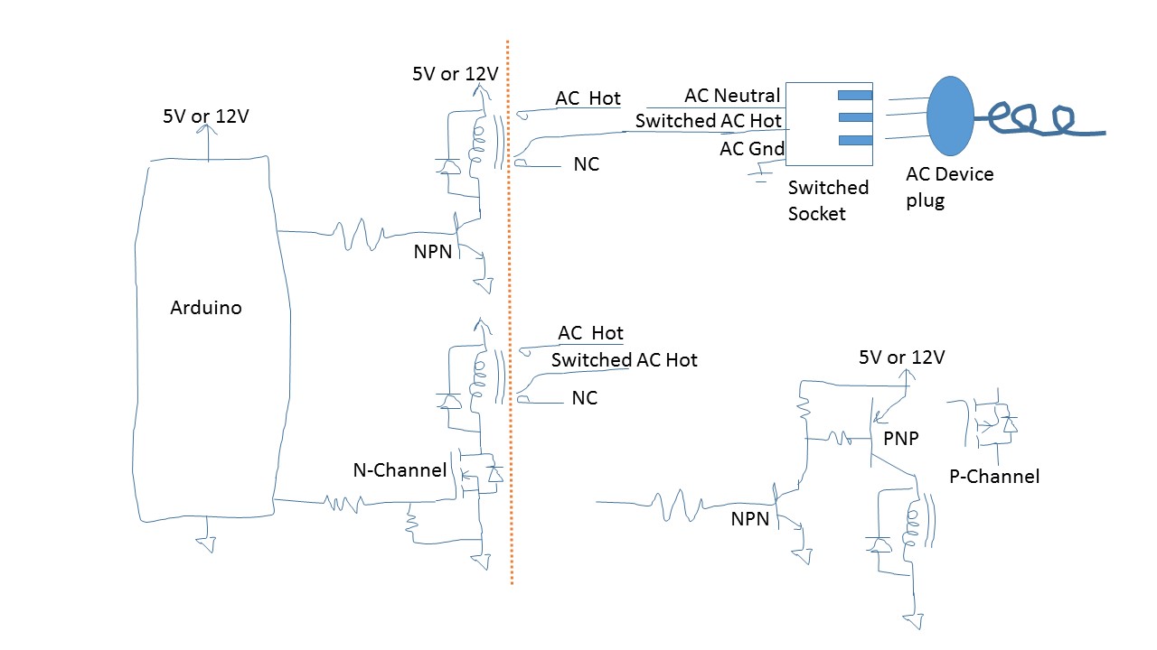

What am I missing or is incorrect here?
Something has to be wrong with my interpretation!!!
OP: Acknowledging you're experienced with mains wiring and safety, I can understand why you're switching the 110vAC, but for the newbies out there, I'd STRONGLY suggest leaving the 24v transformer wired securely and powered on, and only switching the ELV circuits.
This may eliminate some of the switching, as you on,y need to control the valve solenoids, and not the supply.
