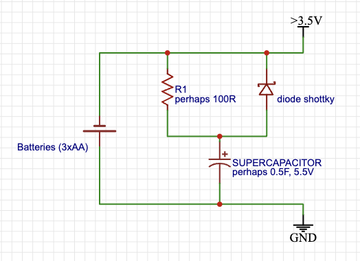

I'm planning a low power data logger deployment that needs to run through the winter, including at temperatures potentially dropping to -40 degrees. In normal operation, the system consumes an average of 290 uA, and so can last on AA batteries for 6+ months. My highest current consumptions are during data writes to an uSD card, which will be avoided as much as possible at the lowest temperatures. I'm trying to keep the deployment compact and closed, but space limitations are not too severe.
To help the batteries at the lowest temperatures, I'm thinking about having a super capacitor in parallel. I'm wondering if the following makes sense? The logger system to be powered operates at 3.3V and includes a 3.3V linear regulator (MCP1700).

Not Lithium at -40. I doubt any 'small' battery will work, maybe something the size of a car battery with a heater.
EDIT: Wow, that chemistry is fantastic for -40 as long as draw is kept to 25mA.
  • I have used these at low temperatures but had problems when temps got below -34°C
Ah, thanks LarryD, not great news for me, but good to hear first-hand experience -- What kind of peak currents were you drawing when things went wrong around -34?
  • Definitely not more than 35mA but don’t know what was flowing when things became intermittent. :cold_face:
Edit
  • The batteries were relatively new but maybe a fresh/new battery would work at -40°C .
    When temps got slightly higher, there was no further intermittent operation.
  • Note to self, next time immediately replace battery with a new one . . . :thinking:
  • Just to fill this out fully, an external AC powered supply was wired in, the intermittent did not return, thus eliminating a circuit problem.
