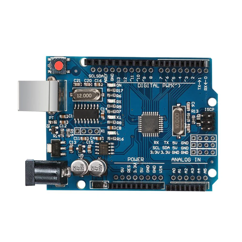

As some of you might know, I purchased a $10 Arduino Uno Knockoff and tested it about a year ago in this post. Since then, I got my hands on an official Uno R4 Minima. The only question is: For less than half the price, can my knockoff board beat the latest and greatest from Arduino? My doubts remain, even greater than last time, so stay tuned for future updates!

  4. I chose to rate the pins on the board because they allow you to power and receive inputs and outputs from/to the board, and the Uno R3 clone got the point because of having double the pins (minus the headers).
Why do you think so? It only has 14 digital pins and 6 analog pins, that can be used as digital pins alternatively. Not more.
Look closer at the pin arrays. They might not be pins, but they are able to conduct and send/receive data just like actual pins. There's a pair of each on the board, along with more I/O holes. in the bottom right.
These vias (solder pads/holes) are merely a convenience for installing alternative connectors, and are connected in parallel with previously defined pins. They add no new features to the basic Arduinu Uno.
