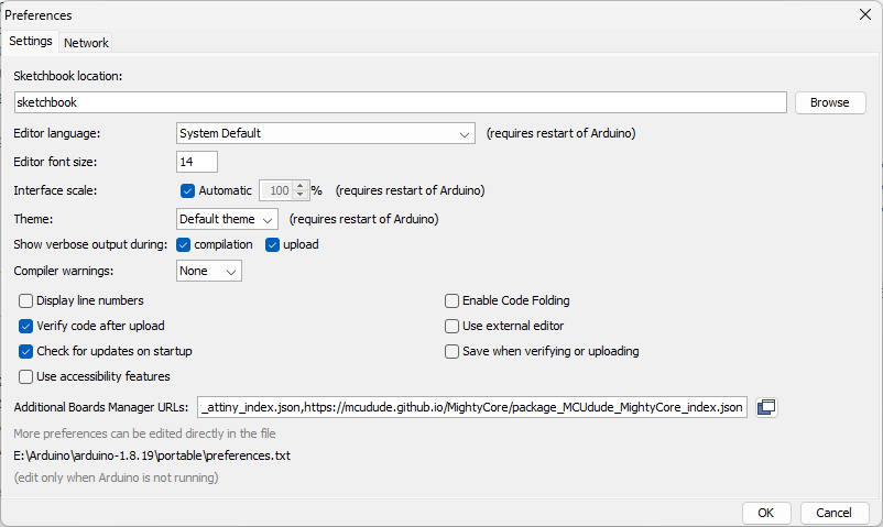

Go in preferences and turn on "show verbose output during" upload
Then try to upload again and copy all error information and show that here.
Use code tags when you post it in the forum
or it will be difficult to read.

If this is a clone 328P Nano, not some other board, then your most likely problem is you need to use the "old Bootloader", not the standard one. Clones almost universally have the old bootloader.
You may also need to download the CH340 driver for the serial-USB interface.
I would like to use the nano that requires LGT8F328. Lets start with that one and see if we can get it to work. If I had room for the UNO I would be very happy ...it works perfectly.
Maybe share your entire sketch, including references to any addon libraries you use.
