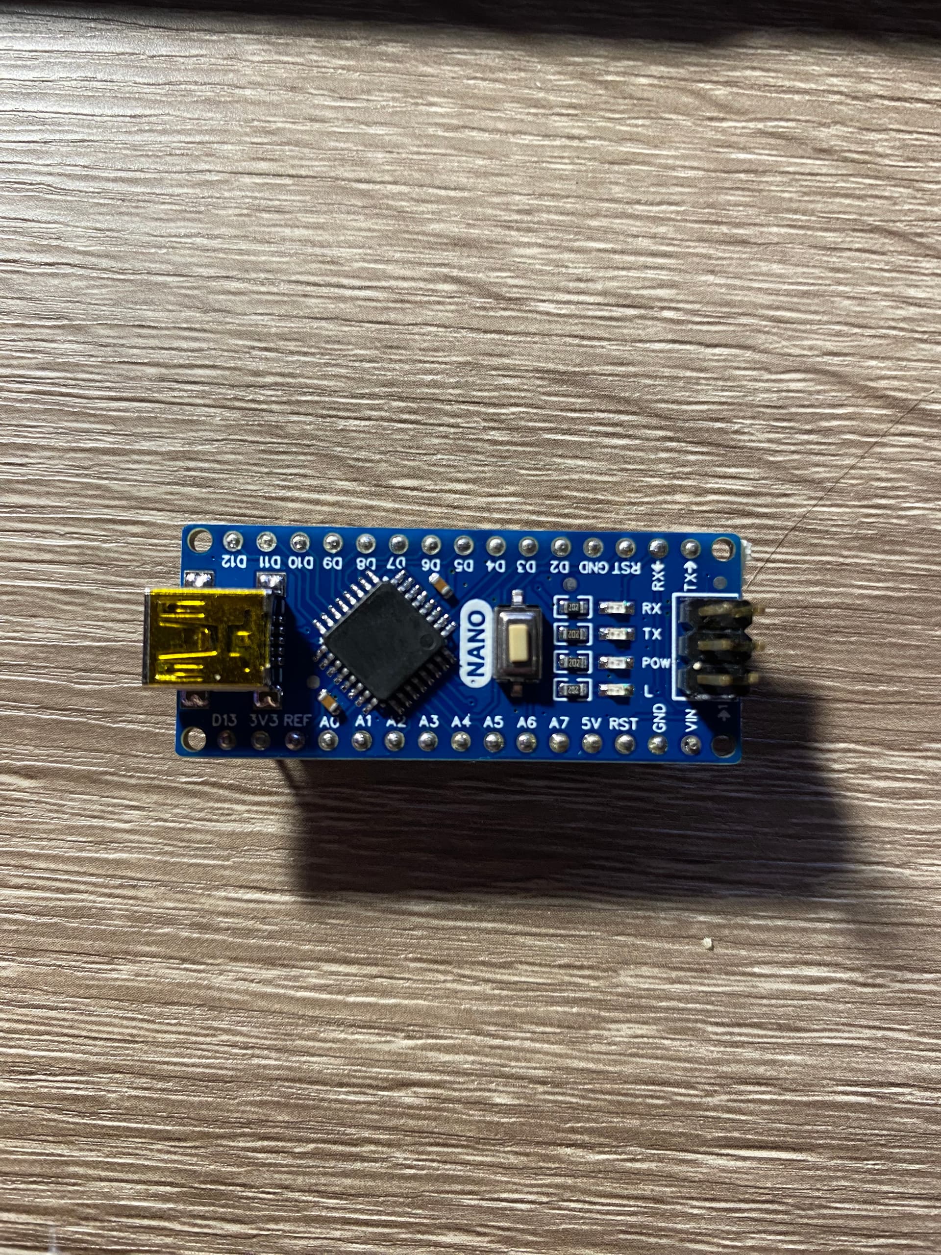

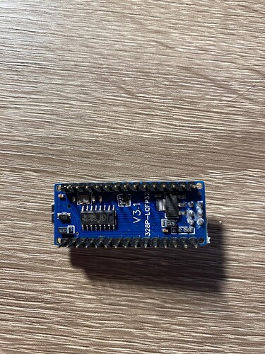

Photos of top and bottom of board would help. Make sure they're focused, and high resolution.
its blinking at 40sec instead of 10 for some reason
I believe I have a real one. I bought a pack of 5 from amazon, it looks like a normal classic and says nano in the middle. my ide version is 2.3.6

Are there any markings at all visible on the main chip.? I'd be interested to see how these clones can be visually identified.
