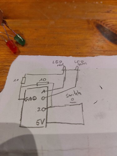

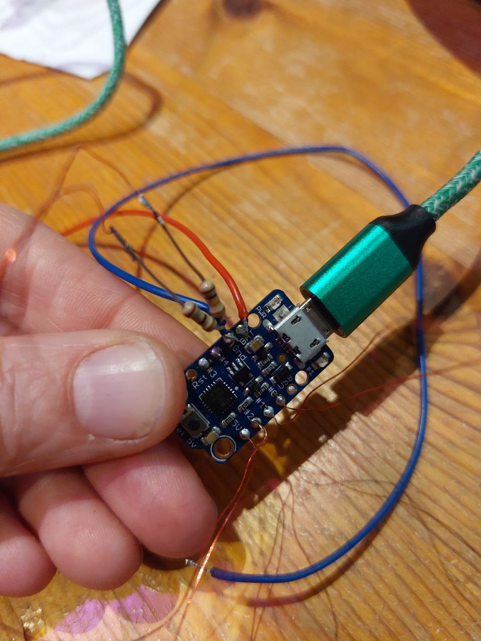

I am trying out the adafruit Trinket 5v for the first time and try to program a simple LED pattern on two LEDS (red and green).
What it should do:
red LED should be on (steady)
on button switch it should blink, turn off and the green led should be on (steady)
Wiring seems to be fine. Attached the LEDs to the pins 0 and 1 and the switch to pin 2.
Sadly it is not doing what i think it should do and I am lost in Coding.
Would be grateful if someone would check my code . Thank you so much in advance for help and comments on the project.
Button
Turns off a light emitting diode(LED) connected to digital pin 0,
when pressing a pushbutton attached to pin 2.
Turns on a greed LED intead attached to pin 1.
The circuit:
- LED attached from pin 3 to ground through 220 ohm resistor
- pushbutton attached to pin 2 from +5V
- 10K resistor attached to pin 2 from ground
