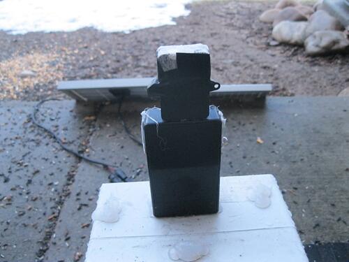

Another aspect to consider. If the environmental sensor is in the same case as the MCU the heat from the MCU will affect the readings.
I came to realize that the sensor must be insulated and isolated from the MCU and the sensor needs to be exposed to the air. Yuppers the electronics will be exposed to the weather.
You'll want to mount the sensor so it can be replaced and you'll want to shield the sensor from the elements.
I found a premade Stevenson Shield, on Amazon. What I had to do was rework the sensor case so it would fit into the shield and make openings in the case so the openings are only exposed in the shields attic.
Put a fine netting over the openings so bugs do not make the sensor case a home.
Yup, there is a BME680 in there that is exposed but protected from the elements.
No snow.
Shield removed. Top box contains the BME680 and insolation, at the bottom of the case. Middle case contains ESP32 and circuity, Bottom case holds the battery, charge controller and 5V regulator.
