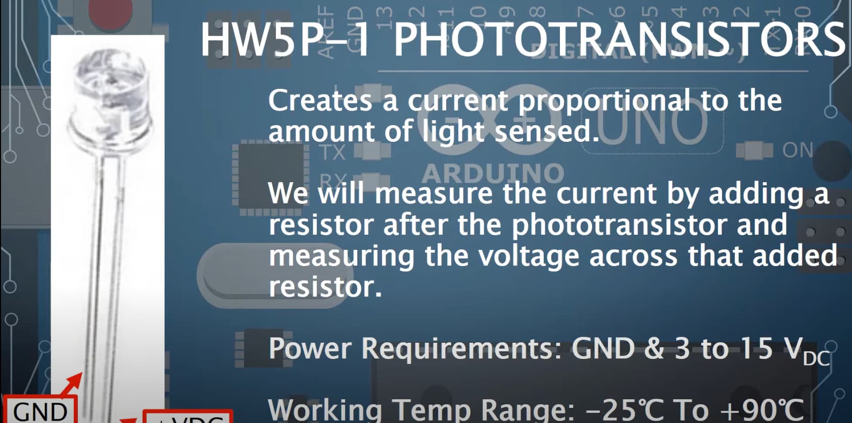

Part of the confusion, apart from me being totally inept, may be due to the fact that the Project Book refers to the devices as "photoresistors". However, after going through my box several times, I concluded that I do not have any devices like those depicted.
From the project book:
I don't have those in my kit. After googling and looking at some video tutorials, I noticed that people were using these instead, so I assume the part may have been updated since the project book was put together:
I have those, and I do get the expected readouts on A0, i.e., almost 5V at full brightness and 0V in darkness. I just don't understand why going from a 1K to a 10K resistor to ground after the transistor does not affect the values I receive on A0.
I am going to buy a multimeter tomorrow to poke and prod a little bit more. That would probably help me understand some of the basic concepts.
Because when there is no light, no current flows through the transistor, so A0 is effectively grounded (0 v)... the resistor is effectively a pull-down resistor.
When you shine light on the transistor it is likely switching to fully open (very low resistance, compared to 10k or 1k) so you now have ~5v at A0.
