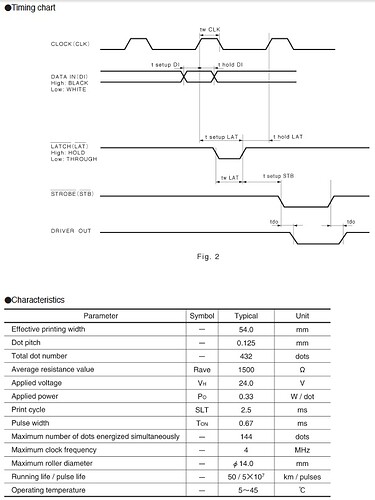

based on the characteristics from the "head_timing.jpg" image, i guess:
total width: 54mm
dot width: 0.125mm
... means 432 dots per line
i think the head only manages one line at a time
while, max energized dots: 144 = 432 / 3
which could be related to the 3 strobes STB !

OK, I have looked at the head timing picture a bit more closely.
Am I right in thinking that it prints across the whole with of the paper without needing to traverse horizontally - I had assumed it would need to move sideways.
It says that it can print a max of 144 dots at one time and that there are 432 dots across.
I presume, then, that you have to load all 432 dots prior to a single print and that no more than 144 of the dots can be 1s. I assume if you need to print more than 144 dots on one line you must do 2 or 3 prints on the same line without moving the paper - and that would mean uploading data 2 or 3 times. Sounds like an interesting coding challenge - especially to do characters. You will need to be very careful with Arduino memory usage.
What is not obvious from the data you have already provided is how you upload the data and, subsequently, how you get it to print. It looks as if you upload the data by successively sending 1s or 0s in sync with the clock. It may be that after you have uploaded all the bits you pull the latch low (or you may need to do that after every bit - but that seems less likely) followed by pulling the stobe low to make it print. Then maybe the driver out goes low to tell you it is printing - so you must wait for it to return to HIGH before uploading more data. This is all very speculative and may be very wide of the mark. Also I don't know if the clock must run constantly - I think it must.
...R

based on that, here's what i'm planning to do, to print one line of dots:
  • CLOCK: digitalWrite HIGH then LOW, let's say every 10 microseconds (to stay less than max clock freq of 4Mhz, as a tryout)
  • DATA: send HIGH/or/LOW of what i want to print, every clock period, 432 times (the whole line width)
  • /LATCH: was HIGH since start, i give one impulse to LOW: it will load/store the "line data"
  • /STROBES: were HIGH (no heating (?)), i put them to LOW sequentially, during 0.5ms each, to heat the paper based on the data previously loaded (~ which stays around the 0.67ms : "pulse width" from datasheet)
note: it seems this model don't have BEO (BlockEnableOut) neither DO (DriverOut) (which seem to be used in coordination with STROBES to release the heating power ... like a protection i guess).
please correct me if i'm doing something wrong, especially about:
  • the Strobes duration (don't want to burn my desk :slight_smile:
  • HIGH/LOW (i find it somehow weird to always keep it HIGH, and then a LOW impulse to heat
This means i need to carefully put all the digitalPins to HIGH at start !

Seems like my guess was pretty much correct - always assuming your print head behaves like the Kyocera.
In the earlier document you linked to it said there was a limit to be number of dots that could be "hot" at one time.
I guess if there are several STROBE pins you can energize them one at a time. But if you only have 1 strobe pin you may need to load an print 2 or three sets of data for one line with a lot of dots.
I suspect there is no need to try a high data rate for initial experiments. I would be content with loading the data at a rate of (say) 2000/sec which would be much easier to manage - unless it says somewhere that there is a minimum rate.
You could wire an external pullup resistor to any pins that have active LOW to ensure they are HIGH by default. You should probably read the Atmel datasheet to figure out exactly what sequence happens if you want a pin to be HIGH before it goes LOW. As far as I recall all the I/O pins default to INPUT which won't cause a problem with the external pullup. But I don't know if you can set a pin HIGH before you switch it to OUTPUT.

As the stepper part is working, (and rotates the paper well) - it's easier for me to run quick / multiple / tests
I think this code is nearly the minimal one to print a single dark line
The getTemperature() in the loop() allows me to stop all the process if i'm heating to much (don't want to destroy the head !)
Here is how it works:
each clock cycle is done using the function: cycle(k)
where k begins at 1 ... until all operations are done
That's why we have:
// CLOCK
  delayMicroseconds(TCLOCK);
  setPinVal(CLK,HIGH);
  setPinVal(CLK,LOW);
where TCLOCK is related to the clock period
Here is the sequence:
(firstly, i put Vh on (a red LED lighting up shows the 24V goes in)
  • k=1 until k=NLAT(432): we send all the data points (all set to HIGH=dark for the test)
  • k=NLAT : we send the LATCH signal (LOW during one/some period) to load the data
  • then each STROBE signal: 1/2/3 (LOW during some periods) to heat
i have been trying with different values:
  • TCLOCK = 1, 10, 100 microseconds
  • NLAT duration: here equals 15 periods (but i also tried 1, 2, 30)
  • NSTB: (strobe duration) i even tried 1000/2000 periods (very long)
the temperature (thermistor connected to the analog A0 input) changes a little-little-little bit (measure is working), but nothing gets heated
I got the images from this datasheet, thinking it would be easier to have them all at one place (fullscreen image) to be able to quickly check the pin assigments, cable colors, arduino inputs/outputs
Here is the output of the Serial console
(NB: i updated the code a little bit for better console logs (see github), but same logic)

i'm thinking i may be sending signals to slowly (looking at the milliseconds delays !)
(4=Latch, 1/2/3=Strobes)
(6=Clock and 5=Data are not displayed)
