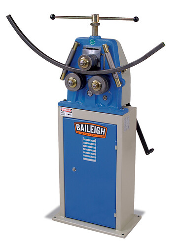

I'm working on a project which requires bending a set of tubes.
I have a setup comparable to the one in the picture:
The way this works is the top roller will be pushed down after which the tube is rolled through to create a curvature. Then the top roller is pushed further to create a bigger curvature.
On the one I'm using I can adjust the horizontal spacing between the two bottom rollers.
As you can imagine it takes guesswork to get the desired curvature.
With a known length of tubing, is there a way to calculate how far I have to push the top roller to get a certain curvature for a specified circle radius?

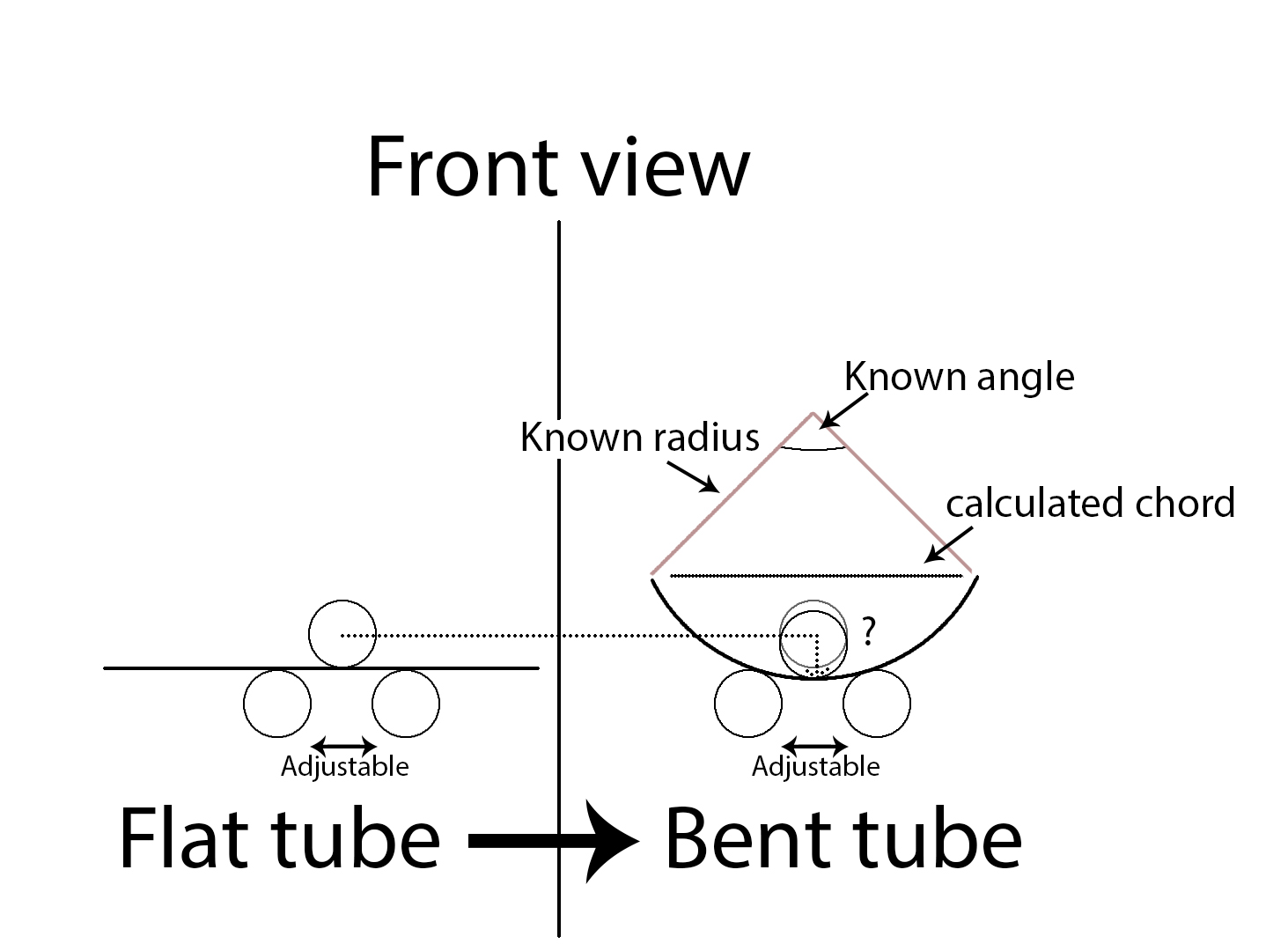

The easy way I would imagine is just get the radius of the circle describing a corner where the arc length is the length of the tube and then calculate the chord.
Then use a string as the chord distance and start bending until I can connect the two ends of the tube with the string without any force.
However I was just wondering if there might be a way to calculate the curvature using the distance between the points where the rollers meet the tube, or any other method for that matter.
The chord calculation would work just fine I imagine, just trying to get some other insights.
To illustrate:
thanks

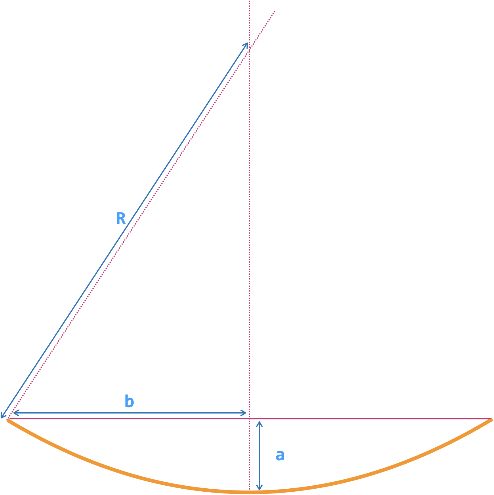

Aha, this looks like something I can work with. Thank you!

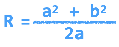

the math comes from Pythagorus in the yellow triangle
R2 = (R-a)2 + b2
⇔ R2 = R2 + a2 -2aR + b2
⇔ 2aR = a2 + b2
⇔ R = (a2 + b2) / 2a

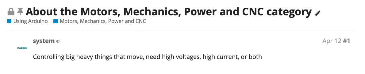

A restriction does not appear to be applied, but this forum is;
Using Arduino \ Motors,Mechanics,Power and CNC
A restriction does...
I'm sorry but I'm not quite sure what you mean..
If it's in the wrong section, please let me know how I can move it to a different one.
that's the category's goal:
so it's pretty generic and your question pertains to controlling your gig. I think it's fine and no big deal.
