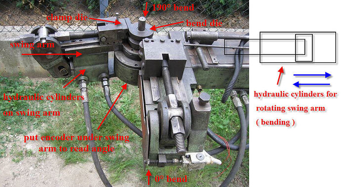

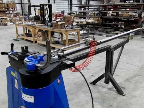

I have hydraulic tube bending machine that I need to controlled with Arduino.
Parts that machine have to be controlled:
-two 110V AC hydraulic solenoid valvs for two hydraulic cylinders - I have documentation for solenoid valvs
  • one hydraulic cylinder for clamping/unclamping die
  • one hydraulic cylinder for rotating swing arm ( bending )
How much I search about Arduino what I need.
-Arduino uno
-Relay board for on/off hydraulic solenoid valvs
-encoder for reading angles ( what resolution I need ) to put under swing arm to read angles
-LCD display + keypad
First to make program how machine will work ( behavior ) - hydraulic cylinder clamp die on swing arm press bend die and rotat to given angle and afrter bending to given angle that hydraulic cylinder on swing arm unclamp and swing arm to return to 0° angle.
-machine can bend from 0-190°.
-swing arm is NOT moving fast

Pictures of machine and hydraulic solenoid valvs.

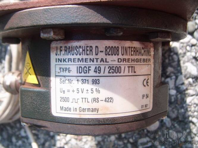

Can I use this encoder on picture. It is 5V 2500 TTL RS-422 .There is enough space to put encoder under swing arm
My machine can bend 0-190° angle and pipe diameter to 40mm ( 1,5'' )
I not need machine to be high tech to do with pressing one button. - I need only to conntrol bending angle.

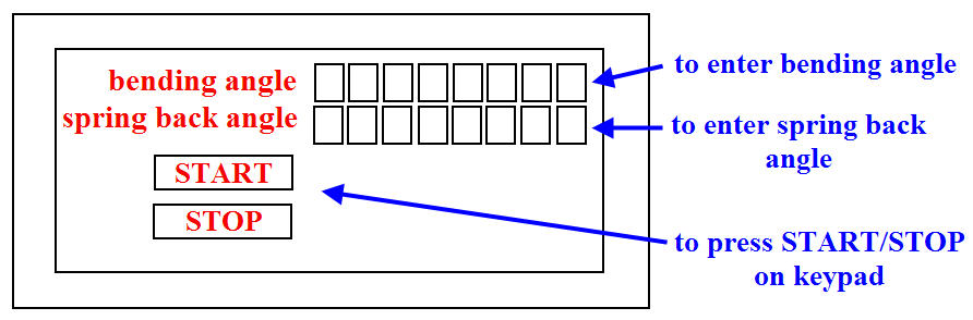

I dont have reference chart for spring back but we can add additional spring back angle for different material, pipe diameter and thickness of the pipe - see picture - to enter on LCD display and enter only when I need to bend certain pipe material, pipe diameter and thickness - I need to test to see what spring back angle is.

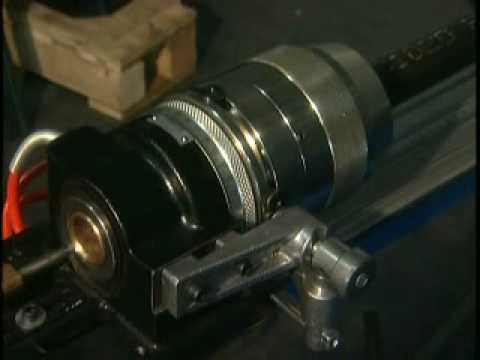

Feeding ( distance between bends ) and rotation pipe will be manually with carrige and lathe chuck to hold pipe see picture ( picture is not from my machine it is only example ). like on this videos Feeding and rotation pipe manually

A 2500 line encoder is a lot of resolution for what you are doing. That is getting you somewhere in the range of dividing each degree in 7 or 8 parts. A lower resolution encoder 360 to 1000 counts would probably do the job. A lower resolution encoder might save you some money also. Make sure the encoder is 5VOLT. Look for an encoder that has 4 wires - +5, Com, A & B. You don't need a fancy encoder to do the job. Look for something like an Omron E6A2-CS3E with voltage output. 360 count would give you 1/2 degree, 500 count would give a few more.
Depending on the code you use to read the encoder you will probably get at least 2 counts for every line, which increases you resolution.
Using an interrupt you would feed A to an interrupr pin configured for CHANGE and it would interrupt on both sides of the lines
As you only need to track 190 degrees, you might consider using an industrial quality pot and just measure the analog voltage for your feedback position. One disadvantage of using a simple quadrature encoder is a lack of a start-up reference position and you will require some other additional sensor to supply that needed information. A pot position is in contrast an absolute position indicator.

Can you provide a picture of the underside of that swing arm? If there's a shaft protruding from it we'd need to know the diameter of it so an encoder could be matched to it.
Chagrin:
There is enough space to put encoder under swing arm.

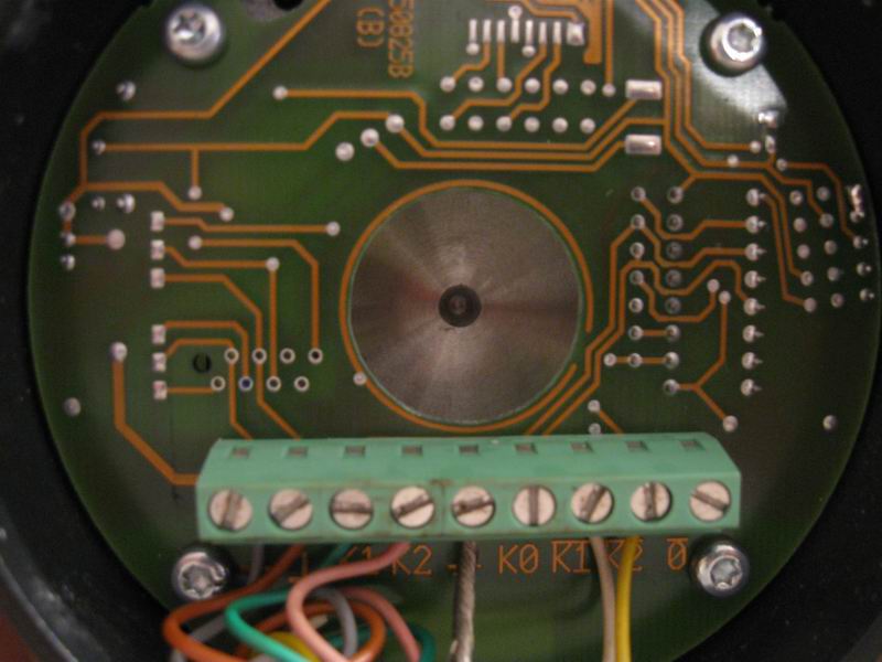

Under encoder cover I find connection data pin/signal/colour for wires.
Kontakt 1 to 4 would be the connections for a typical quadrature encoder; +5V, GND, A, and B. See Arduino Playground - RotaryEncoders for a description of how this works.
It's not at all clear what 5 to 8 would be used for, but I don't think you'll need to worry about those.

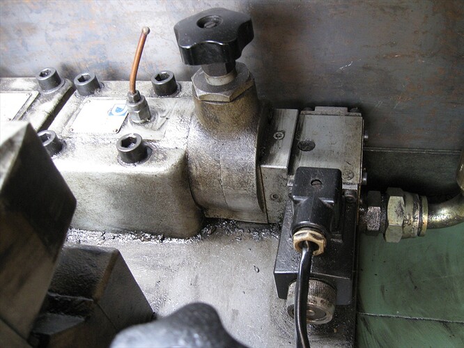

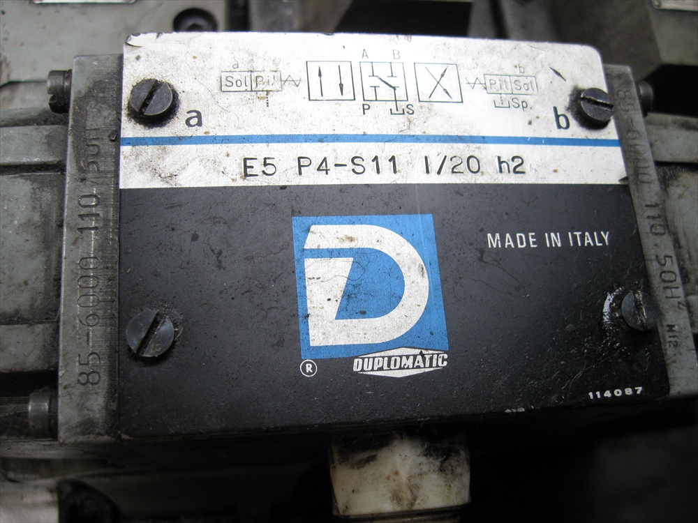

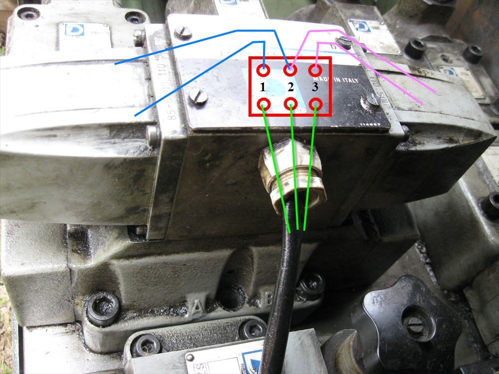

On solenoid valv on picture there is 3 wire ( green wire ). 2 wire left ( blue ) and right ( pink ) and one from both side goes on terminal block number 2 and exit 3 ( green wire ) and question is how to connect 3 wires on relay board NO - NC - C.

This is a dual coil hydraulic valve. You need to use 2 relays to activate these coils. You also should install arc suppressors. I can’t say for certain but the coils are most likely AC at 115 or 230 volts. You use the common on the coils. Where the 2 are together, back to ground. Supply your source voltage to the common of your NC/NO relay. Hook your N/O output to the hydraulic valve coil. If you want to guard against accidently turning both coils on at the same time, feed coil B’s common from coil A’s NC contact.
Coil a will always have priority. Did I mention that need to install arc suppressors?
Good luck…

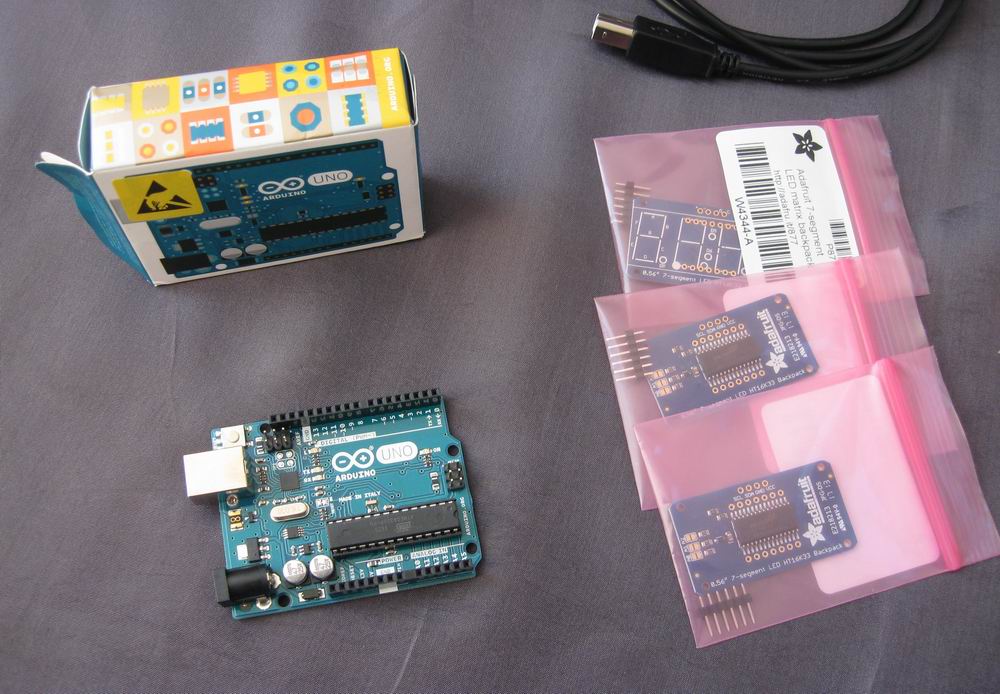

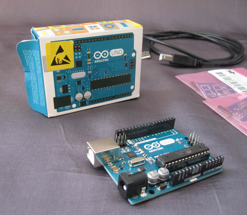

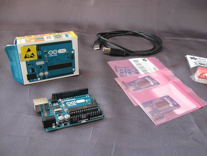

Finally package arrive
  • Arduino Uno
  • Adafruit 0.56" 4-Digit 7-Segment Display w/I2C Backpack - green - blue - red
  • 1,5m cable
what I order
4 x 4 Matrix Keyboard
MB-102 830 breadboards
dupont wire
2 way relay board - for testing
