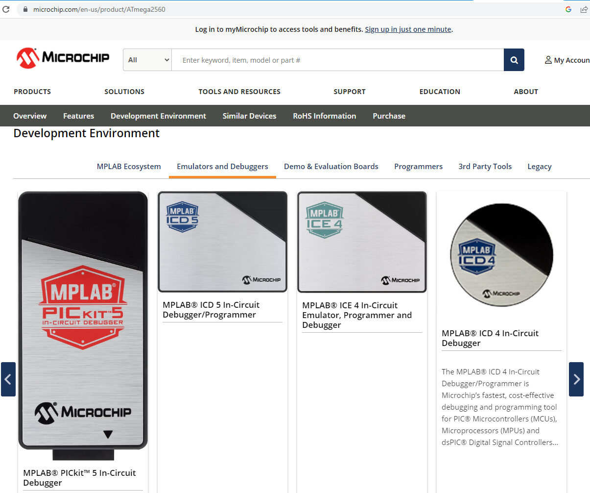

for more, go to the Product Page on the Microchip site:
Note also that some of the XPlained Pro/Mini & Curiosity boards can be used to program & debug external targets
