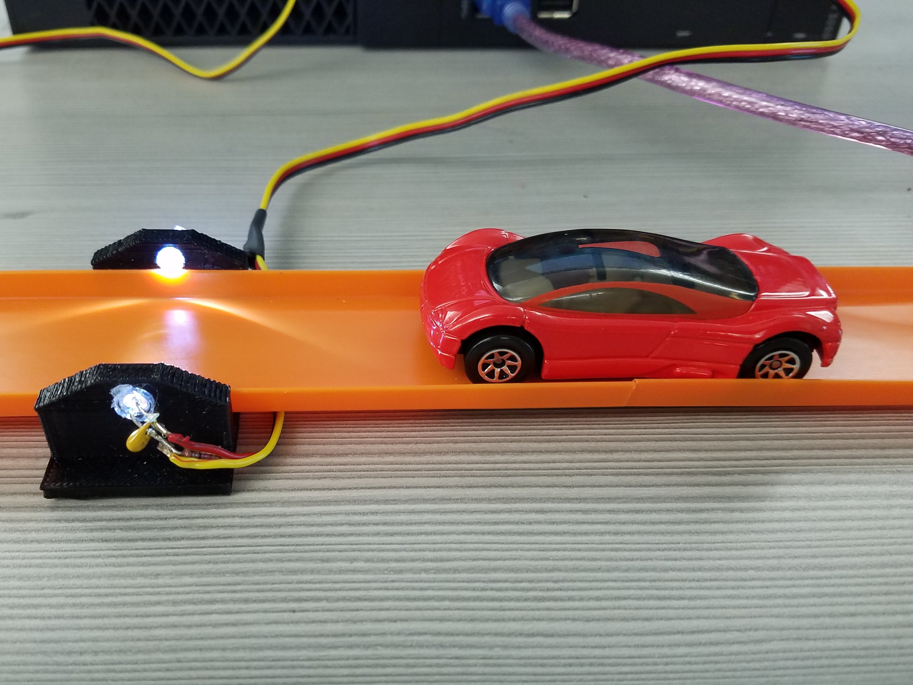

If there is nothing that you can make tilt, a beam of light or a laser may be a better way.

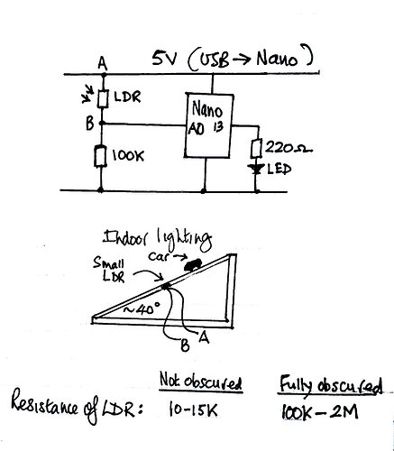

I still think a simple LDR mounted in a hole on the surface in a position whch will ensure that ambient light from above is at least significantly obscured when the ball bearing rolls over it.
Just try it with a piece of thin cardboard or plywood, and see if your DMM resistor range shows it can serve as required. A photo-diode is more sensitive and faster acting but might require a transparent cover unless it has a flat surface.

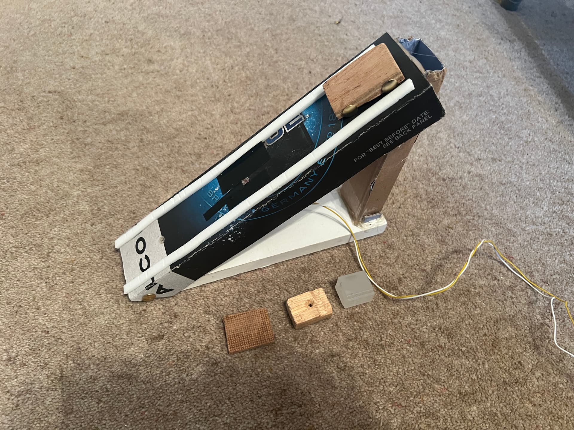

This is the sort of experimental work I'd suggest you do next, either with an LDR as I've done or a photo-diode mounted flushly in the same way.:
With an LDR the circuit as you see couldn't be simpler. At pin A0 of my Nano I was seeing 3.9V and 1.2V respectively in the open and obscured states respectively. My 'toy cars' were scraps of wood, one with four drawing pins to raise it a little above the surface, as that naturally affects the LDR readings.
The more important work, which I'll leave to you for now, is deciding exactly how to use those distinct readings and implementing that with your code.
