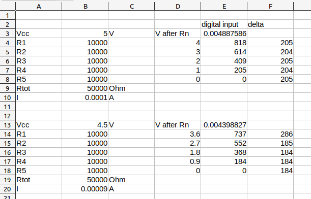

However, I was wondering why the digital values per button are not equally spaced.
It might be clear for most, Vcc may not be the same at each button collection (box) due to difference in cable length, and contact resistances along the way; or the resistors have tolerances, thus have different voltages across them.

I won't address the interval spacing but I will refer you to this Arduino Starter Kit project #7.   Note that your circuit allows the analog input to 'float' when no switch is pressed.

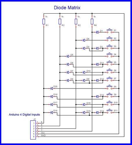

Use a Diode matrix.

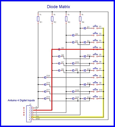

  • Switch #4 in garage sends 0100 (4) to the Arduino.
Note
  • GND and the resistors can be back with the Arduino.
