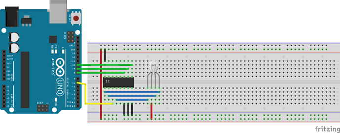

Hello!!! I´m trying to build a 5x8 RGB led matrix. I intended to drive 5 rgb leds rows with a ATmega328 and two 4051 multiplexers. And multiplex the 8 columns with a 4051 connected to an Attiny 85. Wich would be an i2c slave of the mega.
I tested the 4051 analog multiplexing and I can´t make it work as I intend. I attach the wiring of only one led and the code I´m testing.

Let me know if this schematic is what it´s needed to understand it little bit better.

The LED seems to be wired wrong. The common cathode should go to ground, not 5V.
Do you have current limit resistors for the LED(s).
Multiplexers like the 4051 should not be used to drive LEDs they are totally unsuitable for this sort of thing, despite being used in a stupid tutorial on this site.
You´re right groundFungus! It´s wired backwards and it doesn´t have resistors. However, I tried again and it´s not working how I intend. But it´s doing better nonetheless.

Interesting. In what way is it working, but not how you intend? Better in what way? :slight_smile:

So using a TLC5940 is the way to go. Does anybody knows another chip for multiplexing analog values?
You may have a misunderstanding of PWM using the analogWrite function. The analogWrite function does not output an analog voltage. It is a digital pulse train with the duty cycle (% on to % off) encoded in the pulse width.
So you don't need a "chip for multiplexing analog values", you could use a chip for multiplexing LEDs. Like the TLC5940, Max7219 or TPIC6B595 to name a few.
1080glitch:
Why do you want to multiplex analog values? Your signals are digital. If you use a 74HC139 you will get 2 selectors in one package and so you can drive 2 RGBs, each from its own PWM pin.
My favorite chip for producing a PWM signal for RGB LEDs is a PCA9685. It is a set and forget device unlike the others than need constant feeding. You get 16 PWM outputs at 12 bits for each chip, and many chips can be on the I2C bus at the same time ( up to 64 ).
