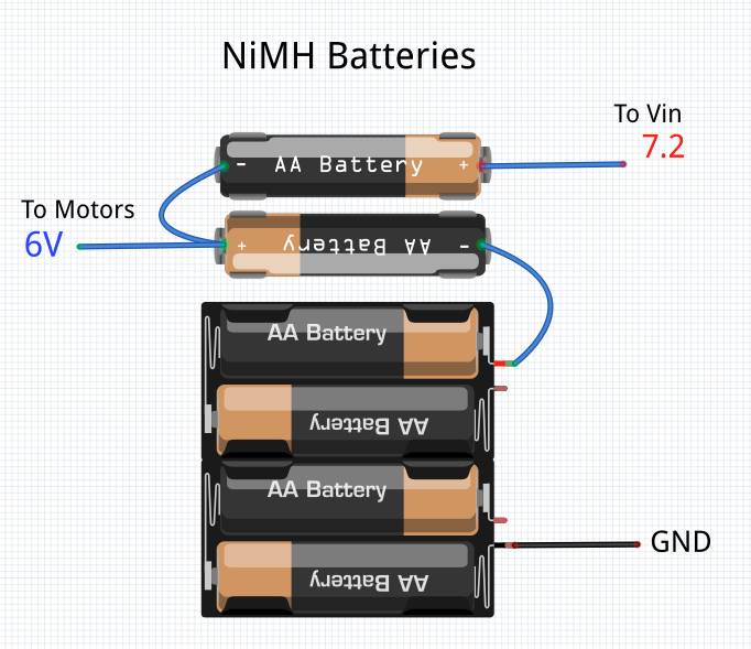

Here is a very simple option with NiMH batteries.
You can connect the HC-05 to the UNO 5V output.
No buck or boost needed.
Should last more than 4 hours.

You can test it with regular AA if you don't have the NiMH batteries yet.
The output marked 4.8V will be 6V and that can go to the motors and servo.
The output marked 7.2V will be 9V and that can go to Vin.
It won't last as long as the NimH batteries.
