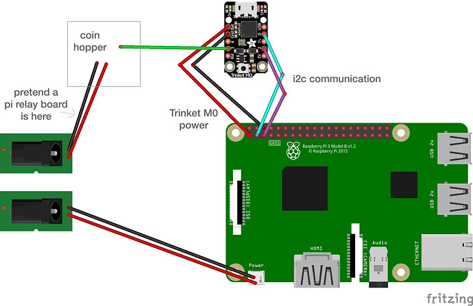

Sending coin hopper ground to the Trinket isn't quite making sense to me yet. Current reasoning (feel free to correct): I would expect that the power outlet powering the hopper would need a ground connection going back to the outlet. I'm already using the Trinket's ground connection to connect to a Raspberry Pi pin as it gets a power connection from there as well. So outlet powers coin hopper. Pi powers the Trinket.
As a visual person, let me attempt to draw out the full picture of my current connections for discussion (see attachment).
Let me know if this helps fill in some gaps, and let me know how this might alter what plugs into what. :slight_smile:

owntheweb:
Fritzing is probably the worst way of doing so, as unsurprisingly it's not making it any clearer.
What is powering the RPi then? The same socket as what powers the coin machine perhaps?
owntheweb:

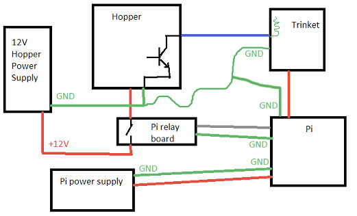

I think this is what you have... and I've added a wiggly green line for the ground you need for the trinket to read that output.
I note that you said:
The coin hopper sensor output is "open collector NPN - active low, maximum sink of 25mA at 35Volt maximum".
...if you have the Hopper Manual as .pdf, post that as well, it might be handy.

TonyWilk:
Perhaps (if and) when you do V2 of the schematic you could also add the pullup resistor to 5V at the Arduino end of the output.

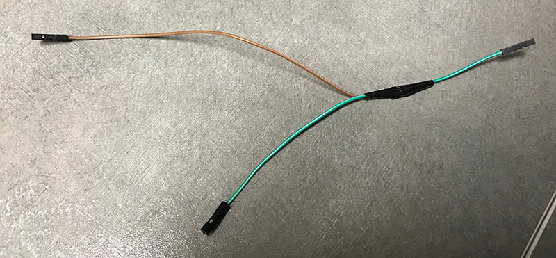

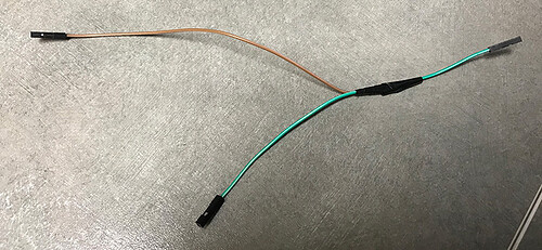

Thank you for the pretty diagram. :smiley:
Ahaa! So maybe my "T" wire (or should we coin the term "Y" wire? [spliced wire]) may do the trick here (über newbness revealed).

owntheweb:
In regards to 5V pullup resistor, if I add that, it would be in-between hopper sensor output and Trinket sensor input?
No it's the internal one, and what I meant @TonyWilk was just to show it internally as I have attached.

wilfredmedlin:
Oh, ok... sorry. Yes, that does make it a lot clearer.
