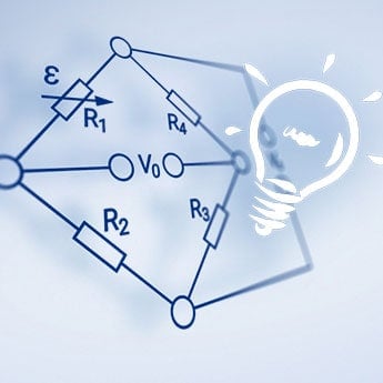

I am working on my thesis which is basically a study on roll cages, and for this, I need to use strain gauges to take some strain readings. at first, I was going to use strain gauges and a Wheatstone bridge but since I am a beginner I am trying to avoid using multiple components to reduce my sources of error and I found another solution, which is to use a BF350 chip instead.

Do you have specs on the board?
It looks a little weird to just have a bare 2-wire sensor attached and no wheatstone bridge or half-bridge.
This says the breakout board has three resistors that complete the Wheatstone bridge:

Ah, one might switch one of the resistors out for a 200 ohm resistor that matches the strain gauge.
Yes, they are SMT, but that would be possible.
Another peculiarity is that it seems the breakout board outputs an analog signal, 0 to 3.5v dc. It's not clear whether the output is ratiometric with the supply or if it has an on-board stable voltage source.
In any case, I think the OP would be better off with a set of four strain gauges and an HX711 or similar. On the other hand, the OP hasn't said much about the application, so maybe the BF350 breakout would be good enough.

Do some simple math:
Use the Wheatstone bridge formula to figure out how the change in resistance in the strain gauge leg (due to the change in wire length) will affect the output.
The possible mismatch between your 350 ohm strain gauge and the completion resistors in the board may have a larger effect.
Neither are likely to be deal-killers, but it would be a good learning exercise to use math to predict the effects.
There's ways to null the differences out, but they mostly work with the other 350 ohm resistance on your strain gauge's half-bridge. Doing a good job nulling out the difference enables you to use higher gains and get greater accuracy, rather than wasting accuracy and range in amplifying the un-nulled constant offset.
