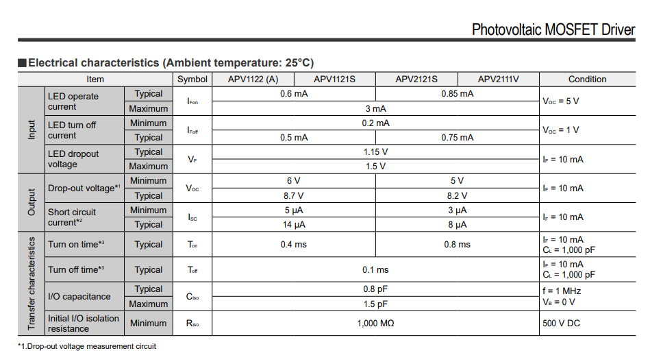

Background: I’m looking to build a module that acts as a bi-directional switch based on mosfets. Call it solid state relay (SSR) if you like. I will have the module made by a PCB manufactory to then be able to use the module in my other designs by soldering it on top, sandwich style. Very modular. :hugs: The steering voltage is +3.3-5V and the switched voltage is +/-15V.
To the subject: I’m looking at building it with two N-channel MOSFETS in a back to back configuration, driven by the photovoltaic MOSFET driver technology. The reason I look at this option is that I cannot for my life find a traditional suitable high side mosfet driver that is reasonably priced (sub $2) and in stock. If you know one, please post a link! =)
The switch will be turned on 90% of the time, in a battery powered application. This leads me to think about the current consumption of the LED in the driver. The datasheets tend to assume 10mA driving current when they draw up the specs. However I see as low as 0.5 mA mentioned in the specs as well.
How low is it possible to go, and still have the MOSFET guaranteed to be fully on?

It should work provided that the diodes permanently support the switched current and are cooled sufficiently - see the Diode Forward Voltage in the data sheet. And you provide a voltage source (or Gnd) to the Driver IC.
Thanks! The question is then, how much current is needed to keep the MOSFET's turned on?
The data sheet says >0.75mA.
But it must also be dependent on the MOSFET characteristics? I cant get my head around how to calculate it.
