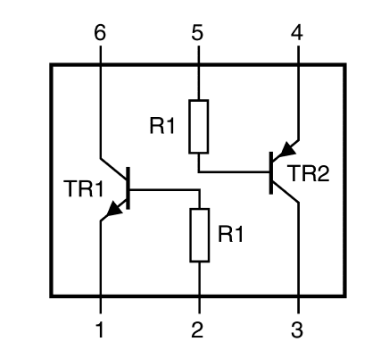

My local supplier stocks this one. 5mA in 60V/500mA out.

Thanks guys! I had no clue SSR could be that small!
I'll pick the jaycar one up as we have that in australia!
It looks perfect for the job

Looking at the circuit diagram. I assume I connect my battery to drain, then source becomes the switched output, like a p channel mosfet...
Is there a difference between the drain pin 4 & 6?
There are two N-channel fets back2back between pin 4 and 6.
So polarity doesn't matter if you use 4 and 6 as a switch.
Leo..
So for clarity:
  1. Use pins 5 and either 4 or 6, if I care about polarity for some reason.
  2. Use pins 4 and 6, if I just want a simple switch, no polarity.
From the Datasheet:
3.4 Repetitive peak off state-voltage 60Vdc min
You should allow some margin for derating. This is on the edge of failure.
