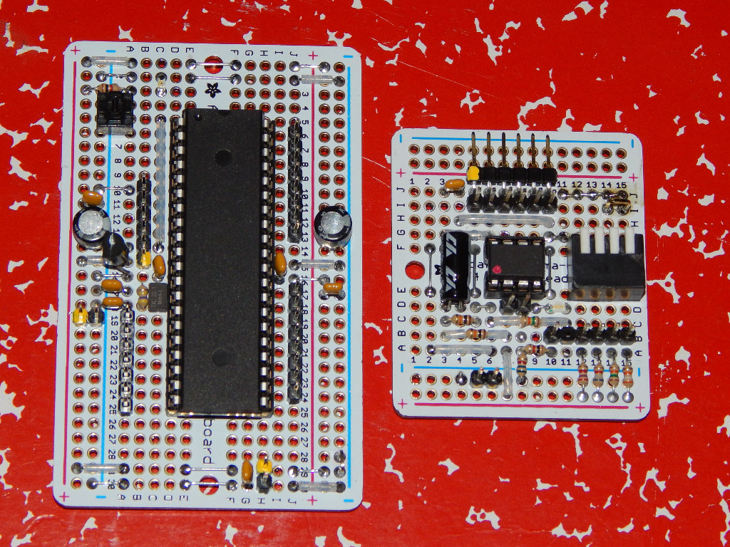

The Adafruit "Perma-Proto" boards have "larger than normal" plated through holes (1.2mm / 0.047" drill).
They are very nicely made, the traces are gold plated and as I said the holes are PTH.
They come in 3 sizes, small, medium and large (or as they call them 1/4 size, 1/2 size and full size).
The holes are large enough to accommodate 3 leads of 1/8 watt resistors, a 1/8 watt resistor or small ceramic cap and an IC socket pin and most everything else.
Check 'em out:
(click pic for link)
Hope this helps.
(edit to add): Here is a pic of a few of my projects, one on a 1/2 size board and the other on a 1/4. The large chip is a 1284P (40 pin) so you can get an idea of the size.
(click pic for larger)
